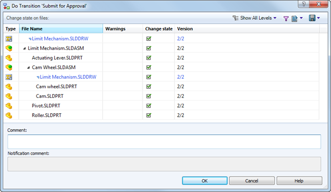

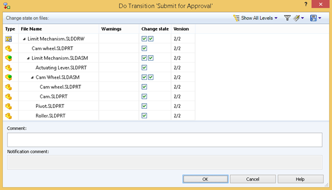

SOLIDWORKS PDM displays an enhanced reference tree with sub-parent relations.
The Get, Set Revision, Do Transition (Change State), Copy Tree, and Move Tree dialog boxes, and the Contains tab display the reference tree with only one node for the selected file that is displayed at the top of the tree.
The sub-parent relation is displayed with the file name in blue and an upward arrow.
If the selected drawing file has multiple references, the sub-parent relation is displayed multiple times in the reference tree.
SOLIDWORKS PDM 2017 |
SOLIDWORKS PDM 2016 |
