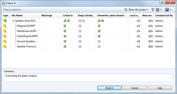

Many of the user interfaces have been changed with version overwrite functionality.
The Check in dialog box displays an Overwrite Latest Version column. This option is turned off by default. You can select it only if the Check in option is selected. To overwrite all files, right-click in the dialog box and click Overwrite Latest Version on All Files or press Ctrl+R.
When you select Overwrite Latest Version, the New ver. column is updated with the latest version value.
The transition's Properties dialog box displays Can overwrite latest version during check in check box. Administrators can set the version overwrite action while running the transition.
