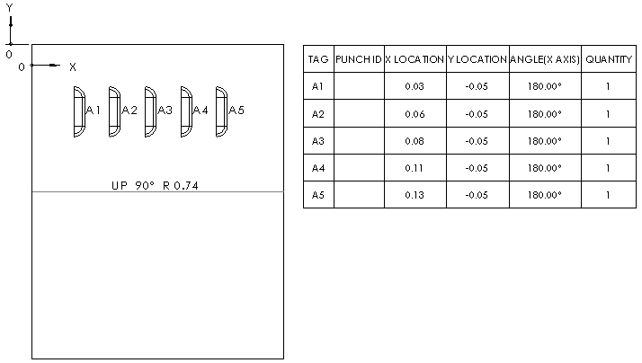

In drawings, you can retrieve sheet metal information from the parent component in mirrored or derived sheet metal components.
For example, if you create a drawing view of a mirrored sheet metal part, any forming tools or library features in the mirrored part are available in punch tables.
When creating a derived part, you need to select Sheet metal information in the Insert Part PropertyManager.
