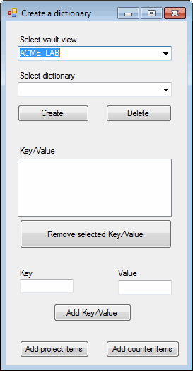

// Postconditions:
// 1. Displays a dialog.
// 2. Select a vault.
// 3. Select the MyProjects dictionary.
//    a. Click Create.
//    b. Click Add project items.
//       The Key/Value list is populated with the
//       MyProjects dictionary's keys and values.
//    c. Type a unique value in Key and any value in Value.
//    d. Click Add Key/Value.
//       The key and value are added to the Key/Value list.
//    e. Select a key and value in the Key/Value list and
//       click Remove selected Key/Value.
//       The selected key and value are deleted from the
//       dictionary.
//    f. Type an existing key in Key and any value in Value.
//    g. Click Add Key/Value.
//       A message box is displayed informing you that the
//       duplicate keys are prohibited. Neither the key
//       nor value was added to the dictionary.
//    h. Click OK to close the message box.
// 4. Select the MyCounters dictionary.
//    a. Click Create.
//    b. Click Add counter items.
//       The Key/Value list is populated with the MyCounters
//       dictionary's keys and values.
// 5. Experiment with creating your own dictionary and adding
//    and removing keys and values to and from that dictionary.
// 6. Close the dialog.

        private void InitializeComponent()
            this.VaultsLabel = new System.Windows.Forms.Label();
            this.VaultsComboBox = new System.Windows.Forms.ComboBox();
            this.DictionaryLabel = new System.Windows.Forms.Label();
            this.DictionaryComboBox = new System.Windows.Forms.ComboBox();
            this.CreateButton = new System.Windows.Forms.Button();
            this.DeleteButton = new System.Windows.Forms.Button();
            this.KeyValueLabel = new System.Windows.Forms.Label();
            this.KeyValueListBox = new System.Windows.Forms.ListBox();
            this.RemoveButton = new System.Windows.Forms.Button();
            this.KeyLabel = new System.Windows.Forms.Label();
            this.KeyTextBox = new System.Windows.Forms.TextBox();
            this.ValueLabel = new System.Windows.Forms.Label();
            this.ValueTextBox = new System.Windows.Forms.TextBox();
            this.AddKeyValueButton = new System.Windows.Forms.Button();
            this.AddProjectItemsButton = new System.Windows.Forms.Button();
            this.AddCounterItemsButton = new System.Windows.Forms.Button();
            this.SuspendLayout();
            // VaultsLabel
            this.VaultsLabel.AutoSize = true;
            this.VaultsLabel.Location = new System.Drawing.Point(13, 27);
            this.VaultsLabel.Name = "VaultsLabel";
            this.VaultsLabel.Size = new System.Drawing.Size(91, 13);
            this.VaultsLabel.TabIndex = 0;
            this.VaultsLabel.Text = "Select vault view:";
            // VaultsComboBox
            this.VaultsComboBox.FormattingEnabled = true;
            this.VaultsComboBox.Location = new System.Drawing.Point(15, 43);
            this.VaultsComboBox.Name = "VaultsComboBox";
            this.VaultsComboBox.Size = new System.Drawing.Size(213, 21);
            this.VaultsComboBox.TabIndex = 1;
            // DictionaryLabel
            this.DictionaryLabel.AutoSize = true;
            this.DictionaryLabel.Location = new System.Drawing.Point(16, 78);
            this.DictionaryLabel.Name = "DictionaryLabel";
            this.DictionaryLabel.Size = new System.Drawing.Size(88, 13);
            this.DictionaryLabel.TabIndex = 2;
            this.DictionaryLabel.Text = "Select dictionary:";
            // DictionaryComboBox
            this.DictionaryComboBox.FormattingEnabled = true;
            this.DictionaryComboBox.Items.AddRange(new object[] { "MyProjects""MyCounters" });
            this.DictionaryComboBox.Location = new System.Drawing.Point(15, 94);
            this.DictionaryComboBox.Name = "DictionaryComboBox";
            this.DictionaryComboBox.Size = new System.Drawing.Size(210, 21);
            this.DictionaryComboBox.TabIndex = 3;
            // CreateButton
            this.CreateButton.Location = new System.Drawing.Point(16, 121);
            this.CreateButton.Name = "CreateButton";
            this.CreateButton.Size = new System.Drawing.Size(75, 23);
            this.CreateButton.TabIndex = 4;
            this.CreateButton.Text = "Create";
            this.CreateButton.UseVisualStyleBackColor = true;
            this.CreateButton.Click += new System.EventHandler(this.CreateButton_Click);
            // DeleteButton
            this.DeleteButton.Location = new System.Drawing.Point(150, 121);
            this.DeleteButton.Name = "DeleteButton";
            this.DeleteButton.Size = new System.Drawing.Size(75, 23);
            this.DeleteButton.TabIndex = 5;
            this.DeleteButton.Text = "Delete";
            this.DeleteButton.UseVisualStyleBackColor = true;
            this.DeleteButton.Click += new System.EventHandler(this.DeleteButton_Click);
            // KeyValueLabel
            this.KeyValueLabel.AutoSize = true;
            this.KeyValueLabel.Location = new System.Drawing.Point(19, 163);
            this.KeyValueLabel.Name = "KeyValueLabel";
            this.KeyValueLabel.Size = new System.Drawing.Size(57, 13);
            this.KeyValueLabel.TabIndex = 6;
            this.KeyValueLabel.Text = "Key/Value";
            // KeyValueListBox
            this.KeyValueListBox.FormattingEnabled = true;
            this.KeyValueListBox.Location = new System.Drawing.Point(15, 190);
            this.KeyValueListBox.Name = "KeyValueListBox";
            this.KeyValueListBox.Size = new System.Drawing.Size(210, 95);
            this.KeyValueListBox.TabIndex = 7;
            // RemoveButton
            this.RemoveButton.Location = new System.Drawing.Point(16, 301);
            this.RemoveButton.Name = "RemoveButton";
            this.RemoveButton.Size = new System.Drawing.Size(210, 23);
            this.RemoveButton.TabIndex = 8;
            this.RemoveButton.Text = "Remove selected Key/Value";
            this.RemoveButton.UseVisualStyleBackColor = true;
            this.RemoveButton.Click += new System.EventHandler(this.RemoveButton_Click);
            // KeyLabel
            this.KeyLabel.AutoSize = true;
            this.KeyLabel.Location = new System.Drawing.Point(19, 340);
            this.KeyLabel.Name = "KeyLabel";
            this.KeyLabel.Size = new System.Drawing.Size(25, 13);
            this.KeyLabel.TabIndex = 9;
            this.KeyLabel.Text = "Key";
            // KeyTextBox
            this.KeyTextBox.Location = new System.Drawing.Point(19, 356);
            this.KeyTextBox.Name = "KeyTextBox";
            this.KeyTextBox.Size = new System.Drawing.Size(100, 20);
            this.KeyTextBox.TabIndex = 10;
            // ValueLabel
            this.ValueLabel.AutoSize = true;
            this.ValueLabel.Location = new System.Drawing.Point(144, 340);
            this.ValueLabel.Name = "ValueLabel";
            this.ValueLabel.Size = new System.Drawing.Size(34, 13);
            this.ValueLabel.TabIndex = 11;
            this.ValueLabel.Text = "Value";
            // ValueTextBox
            this.ValueTextBox.Location = new System.Drawing.Point(147, 356);
            this.ValueTextBox.Name = "ValueTextBox";
            this.ValueTextBox.Size = new System.Drawing.Size(100, 20);
            this.ValueTextBox.TabIndex = 12;
            // AddKeyValueButton
            this.AddKeyValueButton.Location = new System.Drawing.Point(19, 397);
            this.AddKeyValueButton.Name = "AddKeyValueButton";
            this.AddKeyValueButton.Size = new System.Drawing.Size(228, 23);
            this.AddKeyValueButton.TabIndex = 13;
            this.AddKeyValueButton.Text = "Add Key/Value";
            this.AddKeyValueButton.UseVisualStyleBackColor = true;
            this.AddKeyValueButton.Click += new System.EventHandler(this.AddKeyValueButton_Click);
            // AddProjectItemsButton
            this.AddProjectItemsButton.Location = new System.Drawing.Point(19, 438);
            this.AddProjectItemsButton.Name = "AddProjectItemsButton";
            this.AddProjectItemsButton.Size = new System.Drawing.Size(100, 23);
            this.AddProjectItemsButton.TabIndex = 14;
            this.AddProjectItemsButton.Text = "Add project items";
            this.AddProjectItemsButton.UseVisualStyleBackColor = true;
            this.AddProjectItemsButton.Click += new System.EventHandler(this.AddProjectItemsButton_Click);
            // AddCounterItemsButton
            this.AddCounterItemsButton.Location = new System.Drawing.Point(136, 438);
            this.AddCounterItemsButton.Name = "AddCounterItemsButton";
            this.AddCounterItemsButton.Size = new System.Drawing.Size(110, 23);
            this.AddCounterItemsButton.TabIndex = 15;
            this.AddCounterItemsButton.Text = "Add counter items";
            this.AddCounterItemsButton.UseVisualStyleBackColor = true;
            this.AddCounterItemsButton.Click += new System.EventHandler(this.AddCounterItemsButton_Click);
            // Form1
            this.AutoScaleDimensions = new System.Drawing.SizeF(6F, 13F);
            this.AutoScaleMode = System.Windows.Forms.AutoScaleMode.Font;
            this.ClientSize = new System.Drawing.Size(284, 482);
            this.Controls.Add(this.AddCounterItemsButton);
            this.Controls.Add(this.AddProjectItemsButton);
            this.Controls.Add(this.AddKeyValueButton);
            this.Controls.Add(this.ValueTextBox);
            this.Controls.Add(this.ValueLabel);
            this.Controls.Add(this.KeyTextBox);
            this.Controls.Add(this.KeyLabel);
            this.Controls.Add(this.RemoveButton);
            this.Controls.Add(this.KeyValueListBox);
            this.Controls.Add(this.KeyValueLabel);
            this.Controls.Add(this.DeleteButton);
            this.Controls.Add(this.CreateButton);
            this.Controls.Add(this.DictionaryComboBox);
            this.Controls.Add(this.DictionaryLabel);
            this.Controls.Add(this.VaultsComboBox);
            this.Controls.Add(this.VaultsLabel);
            this.Name = "Form1";
            this.Text = "Create a dictionary";
            this.Load += new System.EventHandler(this.AddDictionary_Load);
            this.ResumeLayout(false);
            this.PerformLayout();
