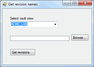

' 5. Click Debug > Start Debugging or press F5.
' Postconditions:
' 1. Displays the Get revision names dialog box.
' 2. Select a vault view.
' 3. Click Browse.
' 4. Displays the Select a file dialog box.
'    a. Click the file identified in Preconditions step 4 in the
'       selected vault.
'    b. Click Open to display the selected file's path and file
'       name in the Get revision names dialog box.
' 5. Click Get revisions.
' 6. Displays a message box listing the names of the revisions
'    for the selected file. Click OK to close the message box.
' 7. Displays a message box showing the revision to which the file
'    was rolled back and the current version. Click OK to close the
'    message box.
' 8. Close the Get revision names dialog box.
' 9. Click the file in the vault in Windows Explorer for which revisions
'    were rolled back.
'    a. Click Display > History.
'    b. Scroll down and examine the Event, Version, and Comment columns.

        Me.VaultsLabel = New System.Windows.Forms.Label()
        Me.VaultsComboBox = New System.Windows.Forms.ComboBox()
        Me.FileListBox = New System.Windows.Forms.ListBox()
        Me.BrowseButton = New System.Windows.Forms.Button()
        Me.RevisionButton = New System.Windows.Forms.Button()
        Me.OpenFileDialog1 = New System.Windows.Forms.OpenFileDialog()
        Me.SuspendLayout()
        'VaultsLabel
        Me.VaultsLabel.AutoSize = True
        Me.VaultsLabel.Location = New System.Drawing.Point(24, 27)
        Me.VaultsLabel.Name = "VaultsLabel"
        Me.VaultsLabel.Size = New System.Drawing.Size(91, 13)
        Me.VaultsLabel.TabIndex = 0
        Me.VaultsLabel.Text = "Select vault view:"
        'VaultsComboBox
        Me.VaultsComboBox.FormattingEnabled = True
        Me.VaultsComboBox.Location = New System.Drawing.Point(27, 44)
        Me.VaultsComboBox.Name = "VaultsComboBox"
        Me.VaultsComboBox.Size = New System.Drawing.Size(166, 21)
        Me.VaultsComboBox.TabIndex = 1
        'OpenFileDialog1
        Me.OpenFileDialog1.FileName = "OpenFileDialog1"
        Me.OpenFileDialog1.Multiselect = True
        Me.OpenFileDialog1.Title = "Select a file"
        'FileListBox
        Me.FileListBox.FormattingEnabled = True
        Me.FileListBox.Location = New System.Drawing.Point(27, 95)
        Me.FileListBox.Name = "FileListBox"
        Me.FileListBox.Size = New System.Drawing.Size(206, 17)
        Me.FileListBox.TabIndex = 2
        'BrowseButton
        Me.BrowseButton.Location = New System.Drawing.Point(239, 89)
        Me.BrowseButton.Name = "BrowseButton"
        Me.BrowseButton.Size = New System.Drawing.Size(62, 23)
        Me.BrowseButton.TabIndex = 3
        Me.BrowseButton.Text = "Browse..."
        Me.BrowseButton.TextAlign = System.Drawing.ContentAlignment.MiddleLeft
        Me.BrowseButton.UseVisualStyleBackColor = True
        'RevisionButton
        Me.RevisionButton.Location = New System.Drawing.Point(27, 140)
        Me.RevisionButton.Name = "RevisionButton"
        Me.RevisionButton.Size = New System.Drawing.Size(88, 23)
        Me.RevisionButton.TabIndex = 4
        Me.RevisionButton.Text = "Get revisions"
        Me.RevisionButton.TextAlign = System.Drawing.ContentAlignment.MiddleLeft
        Me.RevisionButton.UseVisualStyleBackColor = True
        'Form1
        Me.AutoScaleDimensions = New System.Drawing.SizeF(6.0!, 13.0!)
        Me.AutoScaleMode = System.Windows.Forms.AutoScaleMode.Font
        Me.ClientSize = New System.Drawing.Size(311, 195)
        Me.Controls.Add(Me.RevisionButton)
        Me.Controls.Add(Me.BrowseButton)
        Me.Controls.Add(Me.FileListBox)
        Me.Controls.Add(Me.VaultsComboBox)
        Me.Controls.Add(Me.VaultsLabel)
        Me.Name = "Form1"
        Me.Text = "Get revision names"
        Me.ResumeLayout(False)
