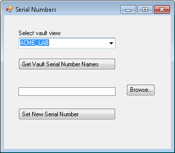

' Postconditions:
'  1. Displays the Serial Numbers dialog box.
'  2. Select a vault view.
'  3. Click Get Vault Serial Number Names.
'  4. Displays a message box containing the names of the serial number
'     generators for the selected vault.
'  5. Click OK to close the message box.
'  6. Click Browse.
'     a. Click a checked-out file in the selected vault whose
'        data card has a Part Number variable.
'     b. Click Open.
'     The selected file's path and file name appear in the Serial
'     Numbers dialog box.
'  7. Click Set New Serial Number
'  8. Displays a message box verifying that the Part Number was
'     set and shows the value of that Part Number.
'     NOTES:
'     * The value set for the Part Number is the next number in the first
'       serial number generator shown in the message box displayed in
'       step 3.
'     * Make note of the Part Number.
'  9. Click OK to close the message box.
' 10. Check in the file whose Part Number was set in step 7, then check out
'     file.
' 11. Examine the Part Number on the data card of the checked-out file.
' 12. Close the Serial Numbers dialog box.

'Form1.Designer.vb
<Global.Microsoft.VisualBasic.CompilerServices.DesignerGenerated()> _
Partial Class Form1
    Inherits System.Windows.Forms.Form
    'Form overrides dispose to clean up the component list.
    <System.Diagnostics.DebuggerNonUserCode()> _
    Protected Overrides Sub Dispose(ByVal disposing As Boolean)
        Try
            If disposing AndAlso components IsNot Nothing Then
                components.Dispose()
            End If
        Finally
            MyBase.Dispose(disposing)
        End Try
    End Sub
    'Required by the Windows Form Designer
    Private components As System.ComponentModel.IContainer
    'NOTE: The following procedure is required by the Windows Form Designer
    'It can be modified using the Windows Form Designer.
    'Do not modify it using the code editor.
    <System.Diagnostics.DebuggerStepThrough()> _
    Private Sub InitializeComponent()
        Me.VaultsLabel = New System.Windows.Forms.Label()
        Me.VaultsComboBox = New System.Windows.Forms.ComboBox()
        Me.Button1 = New System.Windows.Forms.Button()
        Me.FileListBox = New System.Windows.Forms.ListBox()
        Me.OpenFileDialog1 = New System.Windows.Forms.OpenFileDialog()
        Me.BrowseButton = New System.Windows.Forms.Button()
        Me.NewButton = New System.Windows.Forms.Button()
        Me.SuspendLayout()
        'VaultsLabel
        Me.VaultsLabel.AutoSize = True
        Me.VaultsLabel.ImageAlign = System.Drawing.ContentAlignment.MiddleLeft
        Me.VaultsLabel.Location = New System.Drawing.Point(25, 28)
        Me.VaultsLabel.Name = "VaultsLabel"
        Me.VaultsLabel.Size = New System.Drawing.Size(91, 13)
        Me.VaultsLabel.TabIndex = 0
        Me.VaultsLabel.Text = "Select vault view:"
        'VaultsComboBox
        Me.VaultsComboBox.FormattingEnabled = True
        Me.VaultsComboBox.Location = New System.Drawing.Point(28, 44)
        Me.VaultsComboBox.Name = "VaultsComboBox"
        Me.VaultsComboBox.Size = New System.Drawing.Size(190, 21)
        Me.VaultsComboBox.TabIndex = 1
        'Button1
        Me.Button1.ImageAlign = System.Drawing.ContentAlignment.MiddleLeft
        Me.Button1.Location = New System.Drawing.Point(28, 84)
        Me.Button1.Name = "Button1"
        Me.Button1.Size = New System.Drawing.Size(190, 23)
        Me.Button1.TabIndex = 2
        Me.Button1.Text = "Get Vault Serial Number Names"
        Me.Button1.TextAlign = System.Drawing.ContentAlignment.MiddleLeft
        Me.Button1.UseVisualStyleBackColor = True
        'FileListBox
        Me.FileListBox.FormattingEnabled = True
        Me.FileListBox.Location = New System.Drawing.Point(28, 141)
        Me.FileListBox.Name = "FileListBox"
        Me.FileListBox.Size = New System.Drawing.Size(190, 17)
        Me.FileListBox.TabIndex = 3
        'OpenFileDialog1
        Me.OpenFileDialog1.FileName = "OpenFileDialog1"
        Me.OpenFileDialog1.Multiselect = True
        Me.OpenFileDialog1.Title = "Select a file"
        'BrowseButton
        Me.BrowseButton.Location = New System.Drawing.Point(239, 135)
        Me.BrowseButton.Name = "BrowseButton"
        Me.BrowseButton.Size = New System.Drawing.Size(56, 23)
        Me.BrowseButton.TabIndex = 4
        Me.BrowseButton.Text = "Browse..."
        Me.BrowseButton.TextAlign = System.Drawing.ContentAlignment.MiddleLeft
        Me.BrowseButton.UseVisualStyleBackColor = True
        'NewButton
        Me.NewButton.Location = New System.Drawing.Point(28, 182)
        Me.NewButton.Name = "NewButton"
        Me.NewButton.Size = New System.Drawing.Size(190, 23)
        Me.NewButton.TabIndex = 5
        Me.NewButton.Text = "Set New Serial Number"
        Me.NewButton.TextAlign = System.Drawing.ContentAlignment.MiddleLeft
        Me.NewButton.UseVisualStyleBackColor = True
        'Form1
        Me.AutoScaleDimensions = New System.Drawing.SizeF(6.0!, 13.0!)
        Me.AutoScaleMode = System.Windows.Forms.AutoScaleMode.Font
        Me.ClientSize = New System.Drawing.Size(326, 262)
        Me.Controls.Add(Me.NewButton)
        Me.Controls.Add(Me.BrowseButton)
        Me.Controls.Add(Me.FileListBox)
        Me.Controls.Add(Me.Button1)
        Me.Controls.Add(Me.VaultsComboBox)
        Me.Controls.Add(Me.VaultsLabel)
        Me.Name = "Form1"
        Me.Text = "Serial Numbers"
        Me.ResumeLayout(False)
        Me.PerformLayout()
    End Sub
    Friend WithEvents VaultsLabel As System.Windows.Forms.Label
    Friend WithEvents VaultsComboBox As System.Windows.Forms.ComboBox
    Friend WithEvents Button1 As System.Windows.Forms.Button
    Friend WithEvents FileListBox As System.Windows.Forms.ListBox
    Friend WithEvents BrowseButton As System.Windows.Forms.Button
    Friend WithEvents NewButton As System.Windows.Forms.Button
    Friend WithEvents OpenFileDialog1 As System.Windows.Forms.OpenFileDialog
End Class
