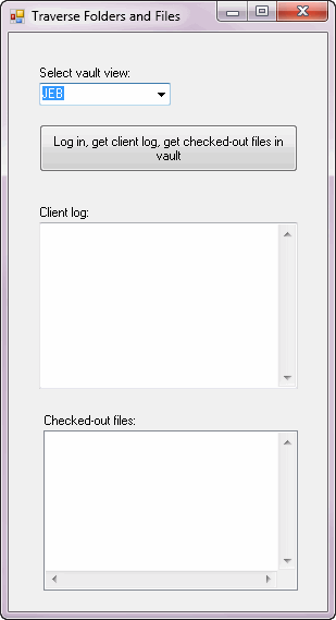

// 11. Ensure that the vault contains one or more checked-out files.
// 12. Click Debug > Start Debugging or press F5.
// Postconditions:
// 1. Displays a Traverse Folders and Files dialog.
// 2. Select a vault.
// 3. Click Log in, get client log, get checked-out files in vault.
// 4. Displays a message box with the vault type.
// 5. Click OK.
// 6. Populates Client log and Checked-out files.
// 7. Close the dialog.

            this.Name = "Form1";
            this.Text = "Traverse Folders and Files";
            this.Load += new System.EventHandler(this.TraverseFilesAndFolders_Load);
