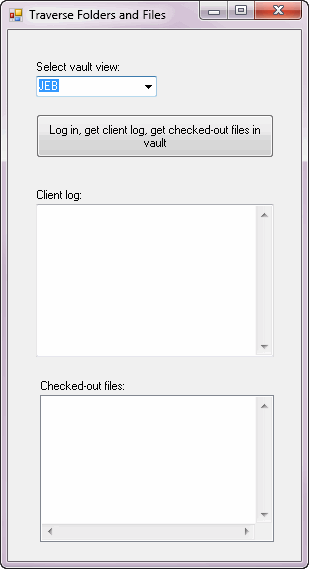

' 1. Displays a Traverse Folders and Files dialog.
' 2. Select a vault.
' 3. Click Log in, get client log, get checked-out files in vault.
' 4. Displays a message box with the vault type.
' 5. Click OK.
' 6. Populates Client log and Checked-out files.
' 7. Close the dialog.
