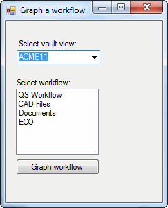

Graph a Workflow Example (VB.NET)
This example shows how to graph a workflow.
NOTE: If using the .NET Framework 4.0 primary interop assembly provided with SOLIDWORKS PDM Professional, see Using .NET Framework 4.0 in Stand-alone Applications.
' Preconditions:
' 1. Start Microsoft Visual Studio 2010.
'    a. Click File > New > Project > Visual Basic > Windows Forms Application.
'    b. Type PaintWorkflowGraph in Name.
'    c. Click Browse and navigate to the folder where to create
'       the project.
'    d. Click OK
'    e. Click Show All Files in the Solution Explorer toolbar and expand
'       Form1.vb in the Solution Explorer.
'    f. Replace the code in Form1.vb with this code.
'    g. To create the form, replace the code in Form1.Designer.vb with this code.
' 2. Add EPDM.Interop.epdm.dll as a reference (right-click the project
'    name in the Solution Explorer, click Add Reference, click
'    Assemblies > Framework in the left-side panel, browse to the top folder of
'    your SOLIDWORKS PDM Professional installation, locate and click
'    EPDM.Interop.epdm.dll, click Open, click Add, and click Close).
' 3. Right-click EPDM.Interop.epdm in References, click Properties, and set
'    Embed Interop Types to False to handle methods that pass arrays of
'    structures.
' 4. Click Debug > Start Debugging or press F5.
' Postconditions:
' 1. Displays the Graph a workflow dialog box.
' 2. Maximize the dialog box for the workflow graph.
' 3. Select a vault view.
' 4. Click a workflow.
' 5. Click Graph workflow
' 6. Graphs the selected workflow in the dialog box.
' 7. Close the Graph a workflow dialog box.

        Me.VaultsLabel = New System.Windows.Forms.Label()
        Me.VaultsComboBox = New System.Windows.Forms.ComboBox()
        Me.GraphWorkflow = New System.Windows.Forms.Button()
        Me.ListBox1 = New System.Windows.Forms.ListBox()
        Me.Label1 = New System.Windows.Forms.Label()
        Me.SuspendLayout()
        'VaultsLabel
        Me.VaultsLabel.Anchor = CType((System.Windows.Forms.AnchorStyles.Bottom Or System.Windows.Forms.AnchorStyles.Right), System.Windows.Forms.AnchorStyles)
        Me.VaultsLabel.AutoSize = True
        Me.VaultsLabel.Location = New System.Drawing.Point(13, 26)
        Me.VaultsLabel.Name = "VaultsLabel"
        Me.VaultsLabel.Size = New System.Drawing.Size(94, 13)
        Me.VaultsLabel.TabIndex = 0
        Me.VaultsLabel.Text = " Select vault view:"
        'VaultsComboBox
        Me.VaultsComboBox.Anchor = CType((System.Windows.Forms.AnchorStyles.Bottom Or System.Windows.Forms.AnchorStyles.Right), System.Windows.Forms.AnchorStyles)
        Me.VaultsComboBox.FormattingEnabled = True
        Me.VaultsComboBox.Location = New System.Drawing.Point(16, 42)
        Me.VaultsComboBox.Name = "VaultsComboBox"
        Me.VaultsComboBox.Size = New System.Drawing.Size(121, 21)
        Me.VaultsComboBox.TabIndex = 1
        'GraphWorkflow
        Me.GraphWorkflow.Anchor = CType((System.Windows.Forms.AnchorStyles.Bottom Or System.Windows.Forms.AnchorStyles.Right), System.Windows.Forms.AnchorStyles)
        Me.GraphWorkflow.Location = New System.Drawing.Point(15, 199)
        Me.GraphWorkflow.Name = "GraphWorkflow"
        Me.GraphWorkflow.Size = New System.Drawing.Size(121, 23)
        Me.GraphWorkflow.TabIndex = 5
        Me.GraphWorkflow.Text = "Graph workflow"
        Me.GraphWorkflow.UseVisualStyleBackColor = True
        'ListBox1
        Me.ListBox1.Anchor = CType((System.Windows.Forms.AnchorStyles.Bottom Or System.Windows.Forms.AnchorStyles.Right), System.Windows.Forms.AnchorStyles)
        Me.ListBox1.FormattingEnabled = True
        Me.ListBox1.HorizontalScrollbar = True
        Me.ListBox1.Location = New System.Drawing.Point(15, 98)
        Me.ListBox1.Name = "ListBox1"
        Me.ListBox1.Size = New System.Drawing.Size(120, 95)
        Me.ListBox1.TabIndex = 6
        'Label1
        Me.Label1.Anchor = CType((System.Windows.Forms.AnchorStyles.Bottom Or System.Windows.Forms.AnchorStyles.Right), System.Windows.Forms.AnchorStyles)
        Me.Label1.AutoSize = True
        Me.Label1.Location = New System.Drawing.Point(13, 82)
        Me.Label1.Name = "Label1"
        Me.Label1.Size = New System.Drawing.Size(85, 13)
        Me.Label1.TabIndex = 7
        Me.Label1.Text = "Select workflow:"
        'Form1
        Me.AutoScaleDimensions = New System.Drawing.SizeF(6.0!, 13.0!)
        Me.AutoScaleMode = System.Windows.Forms.AutoScaleMode.Font
        Me.ClientSize = New System.Drawing.Size(227, 262)
        Me.Controls.Add(Me.Label1)
        Me.Controls.Add(Me.ListBox1)
        Me.Controls.Add(Me.GraphWorkflow)
        Me.Controls.Add(Me.VaultsComboBox)
        Me.Controls.Add(Me.VaultsLabel)
        Me.Name = "Form1"
        Me.Text = "Graph a workflow"
        Me.ResumeLayout(False)
        Me.PerformLayout()
    End Sub
#End Region
