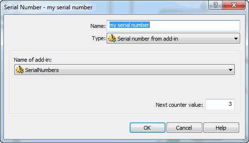

  8. Right-click the Serial Numbers node in the tree and click New Serial Number.
  9. Create a new serial number in the Name field and select Serial number from add-in in the Type dropdown.
    The name of your add-in is displayed in Name of add-in.
  10. After ensuring that your add-in is selected, click OK.

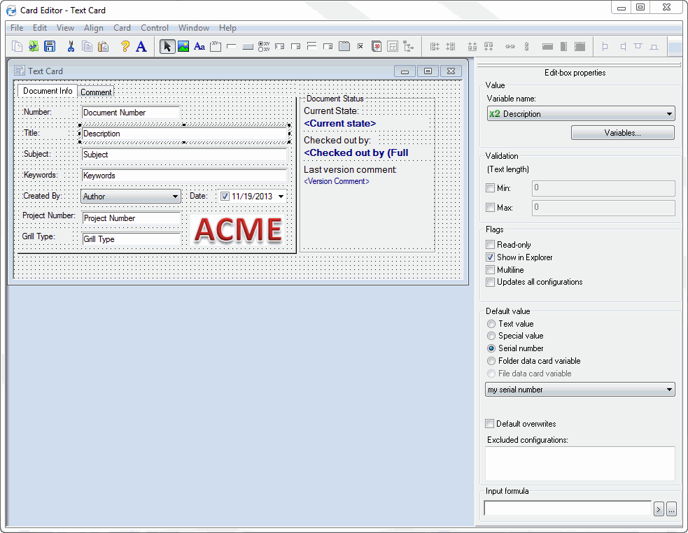

  11. Click Cards > File Cards, double-click Text Card, and click the Title control.
  12. In the Default value group box on the Edit-box properties panel, click Serial number and select the serial number that you created in step 7.
  13.
  14. Save the card and exit the Card Editor.

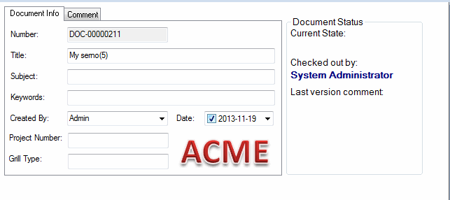

  15. Create a new text file by right-clicking in a Windows Explorer vault view and clicking New > Text Document.
    The file data card displays a serial number in Title of the newly added file.
