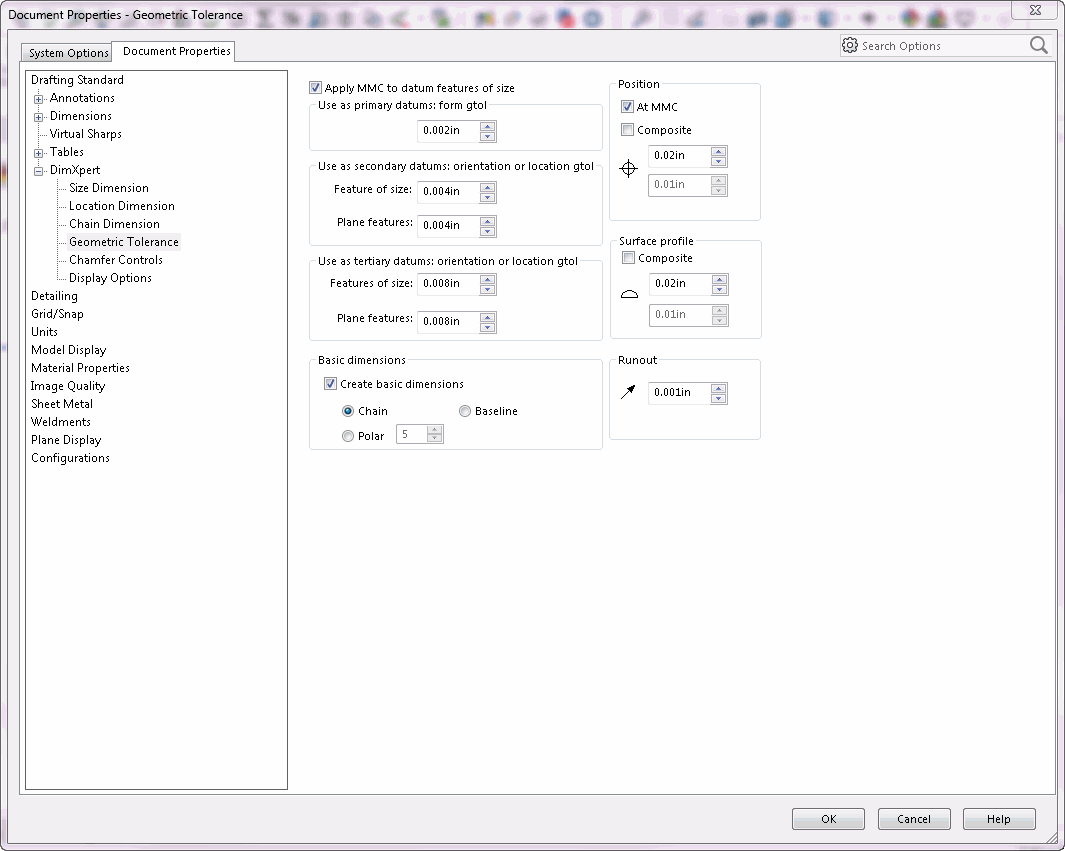

Document Properties > DimXpert > Geometric Tolerance
This topic contains two tables. The information in the table:
  • appearing immediately after the screen capture corresponds to the settings on that dialog.
  • titled Obsolete Enumerators contains enumerators that previously appeared on the dialog, but are now obsolete and no longer appear on that dialog.
Setting
Get/Set Methods
Return Value or <Value>
Comments
Apply MMC to datum features of size
IModelDocExtension::GetUserPreferenceToggle(swUserPreferenceToggle_e.swPartDimXpertGeometricApplyMMC, swUserPreferenceOption_e.swDetailingNoOptionSpecified)
IModelDocExtension::SetUserPreferenceToggle(swUserPreferenceToggle_e.swPartDimXpertGeometricApplyMMC, swUserPreferenceOption_e.swDetailingNoOptionSpecified, <Value>)
Boolean value
Specifies whether an MMC (maximum material condition) symbol is placed in the datum fields when the datum feature is a feature of size
Use as primary datums: form gtol
IModelDocExtension::GetUserPreferenceDouble(swUserPreferenceDoubleValue_e.swPartDimXpertGeometricPrimaryTolValue, swUserPreferenceOption_e.swDetailingNoOptionSpecified)
IModelDocExtension::SetUserPreferenceDouble(swUserPreferenceDoubleValue_e.swPartDimXpertGeometricPrimaryTolValue, swUserPreferenceOption_e.swDetailingNoOptionSpecified, <Value>)
Double value
Sets the tolerance value for the form tolerances that are applied to primary datum features
Use as secondary datums: orientation or location gtol - Feature of size
IModelDocExtension::GetUserPreferenceDouble(swUserPreferenceDoubleValue_e.swPartDimXpertGeometricSecondFeatureSizeTolValue, swUserPreferenceOption_e.swDetailingNoOptionSpecified)
IModelDocExtension::SetUserPreferenceDouble(swUserPreferenceDoubleValue_e.swPartDimXpertGeometricSecondFeatureSizeTolValue, swUserPreferenceOption_e.swDetailingNoOptionSpecified, <Value>)
Double value
Sets the tolerance value for the orientation and location tolerances that are applied to secondary datum features
Use as secondary datums: orientation or location gtol - Plane features
IModelDocExtension::GetUserPreferenceDouble(swUserPreferenceDoubleValue_e.swPartDimXpertGeometricSecondPlaneFeatureTolValue, swUserPreferenceOption_e.swDetailingNoOptionSpecified)
IModelDocExtension::SetUserPreferenceDouble(swUserPreferenceDoubleValue_e.swPartDimXpertGeometricSecondPlaneFeatureTolValue, swUserPreferenceOption_e.swDetailingNoOptionSpecified, <Value>)
Double value
Use as tertiary datums: orientation of location gtol - Features of size
IModelDocExtension::GetUserPreferenceDouble(swUserPreferenceDoubleValue_e.swPartDimXpertGeometricThirdFeatureSizeTolValue, swUserPreferenceOption_e.swDetailingNoOptionSpecified)
IModelDocExtension::SetUserPreferenceDouble(swUserPreferenceDoubleValue_e.swPartDimXpertGeometricThirdFeatureSizeTolValue, swUserPreferenceOption_e.swDetailingNoOptionSpecified, <Value>)
Double value
Sets the tolerance value for the orientation and location tolerances that are applied to tertiary datum features
Use as tertiary datums: orientation or location gtol - Plane features
IModelDocExtension::GetUserPreferenceDouble(swUserPreferenceDoubleValue_e.swPartDimXpertGeometricThirdPlaneFeatureTolValue, swUserPreferenceOption_e.swDetailingNoOptionSpecified)
IModelDocExtension::SetUserPreferenceDouble(swUserPreferenceDoubleValue_e.swPartDimXpertGeometricThirdPlaneFeatureTolValue, swUserPreferenceOption_e.swDetailingNoOptionSpecified, <Value>)
Double value
Basic dimensions - Create basic dimensions
IModelDocExtension::GetUserPreferenceToggle(swUserPreferenceToggle_e.swPartDimXpertGeometricCreateBasicDimension, swUserPreferenceOption_e.swDetailingNoOptionSpecified)
IModelDocExtension::SetUserPreferenceToggle(swUserPreferenceToggle_e.swPartDimXpertGeometricCreateBasicDimension, swUserPreferenceOption_e.swDetailingNoOptionSpecified, <Value>)
Boolean value
Specifies whether to enable the creation of basic dimensions
Basic dimensions - Create basic dimensions - Chain or Baseline or Polar
IModelDocExtension::GetUserPreferenceToggle(swUserPreferenceToggle_e.swBasicDimType, swUserPreferenceOption_e.swDetailingNoOptionSpecified)
IModelDocExtension::SetUserPreferenceToggle(swUserPreferenceToggle_e.swBasicDimType, swUserPreferenceOption_e.swDetailingNoOptionSpecified, swBasicDimType_e.<Value>)
See swBasicDimType_e for valid options
Specifies whether to use chain, baseline, or polar dimension schemes when the creation of basic dimensions is enabled
Basic dimensions - Create basic dimensions - Polar - Minimum # holes
IModelDocExtension::GetUserPreferenceInteger(swUserPreferenceIntegerValue_e.swPolarMinHoles, swUserPreferenceOption_e.swDetailingNoOptionSpecified)
IModelDocExtension::SetUserPreferenceInteger(swUserPreferenceIntegerValue_e.swPolarMinHoles, swUserPreferenceOption_e.swDetailingNoOptionSpecified, <Value>)
Integer value
Specifies the minimum number of holes in a polar dimension scheme
Position - At MMC
IModelDocExtension::GetUserPreferenceToggle(swUserPreferenceToggle_e.swPartDimXpertGeometricPositionAtMMC, swUserPreferenceOption_e.swDetailingNoOptionSpecified)
IModelDocExtension::SetUserPreferenceToggle(swUserPreferenceToggle_e.swPartDimXpertGeometricPositionAtMMC, swUserPreferenceOption_e.swDetailingNoOptionSpecified, <Value>)
Boolean value
Specifies whether to place an MMC symbol
Position - Composite
IModelDocExtension::GetUserPreferenceToggle(swUserPreferenceToggle_e.swPartDimXpertGeometricPositionComposite, swUserPreferenceOption_e.swDetailingNoOptionSpecified)
IModelDocExtension::SetUserPreferenceToggle(swUserPreferenceToggle_e.swPartDimXpertGeometricPositionComposite, swUserPreferenceOption_e.swDetailingNoOptionSpecified, <Value>)
Boolean value
Specifies whether to create composite position tolerances
Position - Tolerance
IModelDocExtension::GetUserPreferenceDouble(swUserPreferenceDoubleValue_e.swPartDimXpertGeometricPositionTolValue, swUserPreferenceOption_e.swDetailingNoOptionSpecified)
IModelDocExtension::SetUserPreferenceDouble(swUserPreferenceDoubleValue_e.swPartDimXpertGeometricPositionTolValue, swUserPreferenceOption_e.swDetailingNoOptionSpecified, <Value>)
Double value
Sets position MMC or position composite tolerance
Position - Composite - Tolerance
IModelDocExtension::GetUserPreferenceDouble(swUserPreferenceDoubleValue_e.swPartDimXpertGeometricPositionCompositeTolValue, swUserPreferenceOption_e.swDetailingNoOptionSpecified)
IModelDocExtension::SetUserPreferenceDouble(swUserPreferenceDoubleValue_e.swPartDimXpertGeometricPositionCompositeTolValue, swUserPreferenceOption_e.swDetailingNoOptionSpecified, <Value>)
Double value
Sets position composite tolerance
Surface profile - Composite
IModelDocExtension::GetUserPreferenceToggle(swUserPreferenceToggle_e.swPartDimXpertGeometricSurfaceProfileComposite, swUserPreferenceOption_e.swDetailingNoOptionSpecified)
IModelDocExtension::SetUserPreferenceToggle(swUserPreferenceToggle_e.swPartDimXpertGeometricSurfaceProfileComposite, swUserPreferenceOption_e.swDetailingNoOptionSpecified, <Value>)
Boolean value
Specifies whether to use tolerance values and criteria when creating surface profile tolerances
Surface profile - Tolerance
IModelDocExtension::GetUserPreferenceDouble(swUserPreferenceDoubleValue_e.swPartDimXpertGeometricSurfaceProfileTolValue, swUserPreferenceOption_e.swDetailingNoOptionSpecified)
IModelDocExtension::SetUserPreferenceDouble(swUserPreferenceDoubleValue_e.swPartDimXpertGeometricSurfaceProfileTolValue, swUserPreferenceOption_e.swDetailingNoOptionSpecified, <Value>)
Double value
Sets surface profile tolerance
Surface profile - Composite - Tolerance
IModelDocExtension::GetUserPreferenceDouble(swUserPreferenceDoubleValue_e.swPartDimXpertGeometricSurfaceProfileCompositeTolValue, swUserPreferenceOption_e.swDetailingNoOptionSpecified)
IModelDocExtension::SetUserPreferenceDouble(swUserPreferenceDoubleValue_e.swPartDimXpertGeometricSurfaceProfileCompositeTolValue, swUserPreferenceOption_e.swDetailingNoOptionSpecified, <Value>)
Double value
Sets composite profile tolerance
Runout
IModelDocExtension::GetUserPreferenceDouble(swUserPreferenceDoubleValue_e.swPartDimXpertGeometricRunoutTolValue, swUserPreferenceOption_e.swDetailingNoOptionSpecified)
IModelDocExtension::SetUserPreferenceDouble(swUserPreferenceDoubleValue_e.swPartDimXpertGeometricRunoutTolValue, swUserPreferenceOption_e.swDetailingNoOptionSpecified, <Value>)
Double value
Sets the tolerance to use when creating runout tolerances
