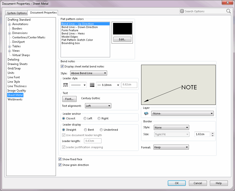

For drawings:
For parts:
For assemblies:
Setting
Get/Set Methods
Return Value or <Value>
Comments
Flat pattern colors - Bend Lines - Up Direction
IModelDocExtension::GetUserPreferenceInteger(swUserPreferenceIntegerValue_e.swSheetMetalColorBendLinesUp, swUserPreferenceOption_e.swDetailingNoOptionSpecified)
IModelDocExtension::SetUserPreferenceInteger(swUserPreferenceIntegerValue_e.swSheetMetalColorBendLinesUp, swUserPreferenceOption_e.swDetailingNoOptionSpecified, <Value>)
Integer RGB value
For drawings only

Bend notes - Display sheet metal bend notes
IModelDocExtension::GetUserPreferenceToggle(swUserPreferenceToggle_e.swShowSheetMetalBendNotes, swUserPreferenceOption_e.swDetailingNoOptionSpecified)
IModelDocExtension::SetUserPreferenceToggle(swUserPreferenceToggle_e.swShowSheetMetalBendNotes, swUserPreferenceOption_e.swDetailingNoOptionSpecified, <Value>)
Boolean value
For drawings only
Specifies whether to show sheet metal bend notes
Bend notes - Style
IModelDocExtension::GetUserPreferenceInteger(swUserPreferenceIntegerValue_e.swBendNoteStyle, swUserPreferenceOption_e.swDetailingNoOptionSpecified)
IModelDocExtension::SetUserPreferenceInteger(swUserPreferenceIntegerValue_e.swBendNoteStyle, swUserPreferenceOption_e.swDetailingNoOptionSpecified, swBendNoteStyle_e.<Value>)
See swBendNoteStyle_e for valid options
For drawings only
Specifies where to place note with respect to bend lines
Bend notes - Leader style - Line style
IModelDocExtension::GetUserPreferenceInteger(swUserPreferenceIntegerValue_e.swSheetMetalBendNotesLeaderLineStyle, swUserPreferenceOption_e.swDetailingNoOptionSpecified)
IModelDocExtension::SetUserPreferenceInteger(swUserPreferenceIntegerValue_e.swSheetMetalBendNotesLeaderLineStyle, swUserPreferenceOption_e.swDetailingNoOptionSpecified, swLineStyles_e.<Value>)
See swLineStyles_e for valid options
For drawings only
Bend notes - Leader style - Line thickness
IModelDocExtension::GetUserPreferenceInteger(swUserPreferenceIntegerValue_e.swSheetMetalBendNotesLeaderLineThickness, swUserPreferenceOption_e.swDetailingNoOptionSpecified)
IModelDocExtension::SetUserPreferenceInteger(swUserPreferenceIntegerValue_e.swSheetMetalBendNotesLeaderLineThickness, swUserPreferenceOption_e.swDetailingNoOptionSpecified, swLineWeights_e.<Value>)
See swLineWeights_e for valid options
For drawings only
If set to Custom Size, you must also set Leader style - Line thickness - Custom Size
Bend notes - Leader style - Line thickness - Custom Size
IModelDocExtension::GetUserPreferenceDouble(swUserPreferenceDoubleValue_e.swSheetMetalBendNotesLeaderLineThicknessCustom, swUserPreferenceOption_e.swDetailingNoOptionSpecified)
IModelDocExtension::SetUserPreferenceDouble(swUserPreferenceDoubleValue_e.swSheetMetalBendNotesLeaderLineThicknessCustom, swUserPreferenceOption_e.swDetailingNoOptionSpecified, <Value>)
Double value
For drawings only
Specifies a custom thickness for leader lines in sheet metal drawings
Bend notes - Text - Font...
IModelDocExtension::GetUserPreferenceTextFormat(swUserPreferenceTextFormat_e.swSheetMetalBendNotesTextFormat, swUserPreferenceOption_e.swDetailingNoOptionSpecified)
IModelDocExtension::SetUserPreferenceTextFormat(swUserPreferenceTextFormat_e.swSheetMetalBendNotesTextFormat, swUserPreferenceOption_e.swDetailingNoOptionSpecified, <Value>)
See ITextFormat for font options
For drawings only
To set font property values, implement ITextFormat, set the appropriate ITextFormat member values, and pass the ITextFormat object in this API's set method
Bend notes - Text - Text alignment
IModelDocExtension::GetUserPreferenceInteger(swUserPreferenceIntegerValue_e.swSheetMetalBendNotesTextAlignment, swUserPreferenceOption_e.swDetailingNoOptionSpecified)
IModelDocExtension::SetUserPreferenceInteger(swUserPreferenceIntegerValue_e.swSheetMetalBendNotesTextAlignment, swUserPreferenceOption_e.swDetailingNoOptionSpecified, swTextJustification_e.<Value>)
See swTextJustification_e for valid options; None is not a valid option
For drawings only
Bend notes - Leader anchor
IModelDocExtension::GetUserPreferenceInteger(swUserPreferenceIntegerValue_e.swSheetMetalBendNotesLeaderAnchor, swUserPreferenceOption_e.swDetailingNoOptionSpecified)
IModelDocExtension::SetUserPreferenceInteger(swUserPreferenceIntegerValue_e.swSheetMetalBendNotesLeaderAnchor, swUserPreferenceOption_e.swDetailingNoOptionSpecified, swLeaderSide_e.<Value>)
See swLeaderSide_e for valid options
For drawings only
Bend notes - Leader display
IModelDocExtension::GetUserPreferenceInteger(swUserPreferenceIntegerValue_e.swSheetMetalBendNotesLeaderDisplay, swUserPreferenceOption_e.swDetailingNoOptionSpecified)
IModelDocExtension::SetUserPreferenceInteger(swUserPreferenceIntegerValue_e.swSheetMetalBendNotesLeaderDisplay, swUserPreferenceOption_e.swDetailingNoOptionSpecified, swLeaderStyle_e.<Value>)
See swLeaderStyle_e for valid options
For drawings only
Bend notes - Leader display - Use document leader length
IModelDocExtension::GetUserPreferenceToggle(swUserPreferenceToggle_e.swSheetMetalBendNotesUseDocLeaderLength, swUserPreferenceOption_e.swDetailingNoOptionSpecified)
IModelDocExtension::SetUserPreferenceToggle(swUserPreferenceToggle_e.swSheetMetalBendNotesUseDocLeaderLength, swUserPreferenceOption_e.swDetailingNoOptionSpecified, <Value>)
Boolean value
For drawings only
Bend notes - Leader display - Leader length
IModelDocExtension::GetUserPreferenceDouble(swUserPreferenceDoubleValue_e.swSheetMetalBendNotesLeaderLength, swUserPreferenceOption_e.swDetailingNoOptionSpecified)
IModelDocExtension::SetUserPreferenceDouble(swUserPreferenceDoubleValue_e.swSheetMetalBendNotesLeaderLength, swUserPreferenceOption_e.swDetailingNoOptionSpecified, <Value>)
Double value
For drawings only
Bend notes - Leader display - Leader justification snapping
IModelDocExtension::GetUserPreferenceToggle(swUserPreferenceToggle_e.swSheetMetalBendNotesLeaderJustificationSnapping, swUserPreferenceOption_e.swDetailingNoOptionSpecified)
IModelDocExtension::SetUserPreferenceToggle(swUserPreferenceToggle_e.swSheetMetalBendNotesLeaderJustificationSnapping, swUserPreferenceOption_e.swDetailingNoOptionSpecified, <Value>)
Boolean value
For drawings only
Bend notes - Layer
IModelDocExtension::GetUserPreferenceString(swUserPreferenceStringValue_e.swSheetMetalBendNotesLayer, swUserPreferenceOption_e.swDetailingNoOptionSpecified)
IModelDocExtension::SetUserPreferenceString(swUserPreferenceStringValue_e.swSheetMetalBendNotesLayer, swUserPreferenceOption_e.swDetailingNoOptionSpecified, <Value>)
Valid Options:
  • "Border"
  • "Dimensions"
  • "Notes"
  • "BOM"
  • "FORMAT"
For drawings only
Bend notes - Border - Style
IModelDocExtension::GetUserPreferenceInteger(swUserPreferenceIntegerValue_e.swSheetMetalBendNotesBorderStyle, swUserPreferenceOption_e.swDetailingNoOptionSpecified)
IModelDocExtension::SetUserPreferenceInteger(swUserPreferenceIntegerValue_e.swSheetMetalBendNotesBorderStyle, swUserPreferenceOption_e.swDetailingNoOptionSpecified, swBalloonStyle_e.<Value>)
See swBalloonStyle_e for valid options; swBS_SplitCir and swBS_Underline are not valid options
For drawings only
Bend notes - Border - Size
IModelDocExtension::GetUserPreferenceInteger(swUserPreferenceIntegerValue_e.swSheetMetalBendNotesBorderSize, swUserPreferenceOption_e.swDetailingNoOptionSpecified)
IModelDocExtension::SetUserPreferenceInteger(swUserPreferenceIntegerValue_e.swSheetMetalBendNotesBorderSize, swUserPreferenceOption_e.swDetailingNoOptionSpecified, swSheetMetalBendNotesBorderSize_e.<Value>)
See swSheetMetalBendNotesBorderSize_e for valid options
For drawings only
If set to swSheetMetalBendNotesBorderSizeUserDefined, you must also set Bend notes - Border - Size - Custom Size
IModelDocExtension::GetUserPreferenceDouble(swUserPreferenceDoubleValue_e.swSheetMetalBendNotesBorderSizeCustom, swUserPreferenceOption_e.swDetailingNoOptionSpecified)
IModelDocExtension::SetUserPreferenceDouble(swUserPreferenceDoubleValue_e.swSheetMetalBendNotesBorderSizeCustom, swUserPreferenceOption_e.swDetailingNoOptionSpecified, <Value>)
Double value
For drawings only

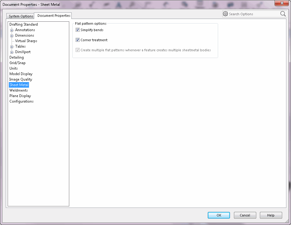

Flat pattern options - Simplify bends
IModelDocExtension::GetUserPreferenceToggle(swUserPreferenceToggle_e.swFlatPatternOpt_SimplifyBends, swUserPreferenceOption_e.swDetailingNoOptionSpecified)
IModelDocExtension::SetUserPreferenceToggle(swUserPreferenceToggle_e.swFlatPatternOpt_SimplifyBends, swUserPreferenceOption_e.swDetailingNoOptionSpecified, <Value>)
Boolean value
For parts and assemblies only
Flat pattern options - Corner treatment
IModelDocExtension::GetUserPreferenceToggle(swUserPreferenceToggle_e.swFlatPatternOpt_CornerTreatment, swUserPreferenceOption_e.swDetailingNoOptionSpecified)
IModelDocExtension::SetUserPreferenceToggle(swUserPreferenceToggle_e.swFlatPatternOpt_CornerTreatment, swUserPreferenceOption_e.swDetailingNoOptionSpecified, <Value>)
Boolean value
Flat pattern options - Create multiple flat patterns whenever a feature creates multiple sheet metal bodies
IModelDocExtension::GetUserPreferenceToggle(swUserPreferenceToggle_e.swFlatPatternOpt_DisableSplitters, swUserPreferenceOption_e.swDetailingNoOptionSpecified)
IModelDocExtension::SetUserPreferenceToggle(swUserPreferenceToggle_e.swFlatPatternOpt_DisableSplitters, swUserPreferenceOption_e.swDetailingNoOptionSpecified, <Value>)
Boolean value

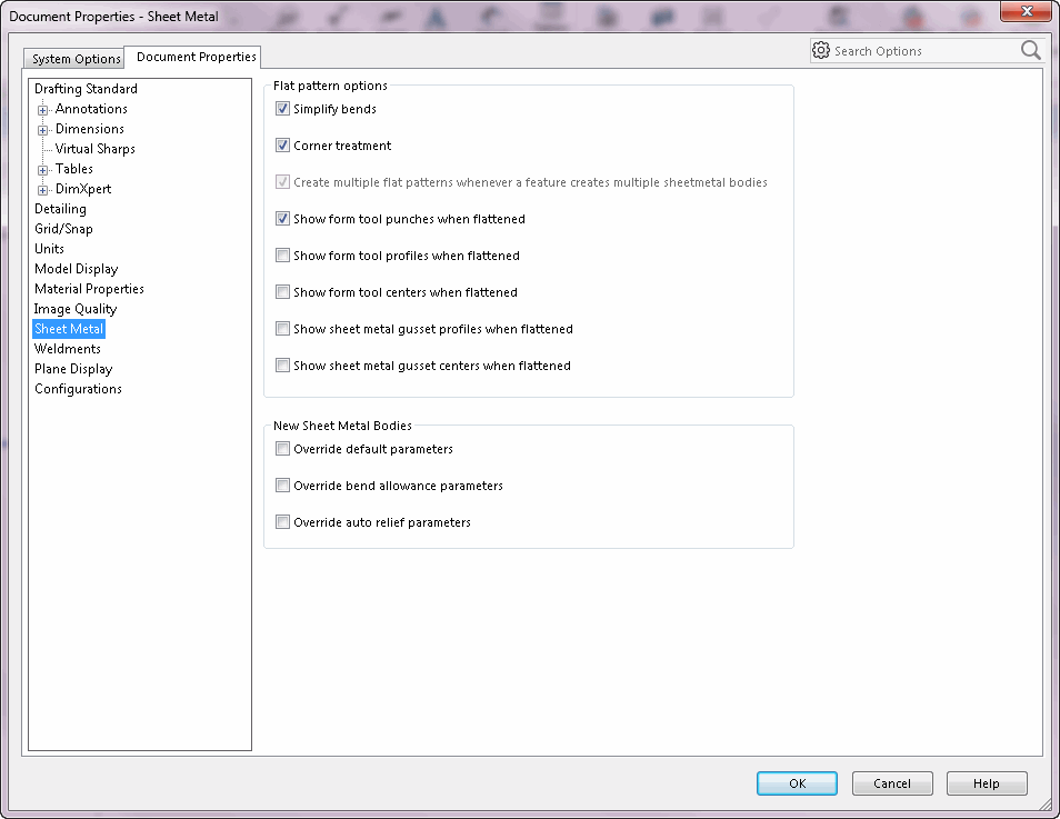

Flat pattern options - Show form tool punches when flattened
IModelDocExtension::GetUserPreferenceToggle(swUserPreferenceToggle_e.swFlatPatternOpt_ShowPunches, swUserPreferenceOption_e.swDetailingNoOptionSpecified)
IModelDocExtension::SetUserPreferenceToggle(swUserPreferenceToggle_e.swFlatPatternOpt_ShowPunches, swUserPreferenceOption_e.swDetailingNoOptionSpecified, <Value>)
Boolean value
For parts only
Flat pattern options - Show form tool profiles when flattened
IModelDocExtension::GetUserPreferenceToggle(swUserPreferenceToggle_e.swFlatPatternOpt_ShowProfiles, swUserPreferenceOption_e.swDetailingNoOptionSpecified)
IModelDocExtension::SetUserPreferenceToggle(swUserPreferenceToggle_e.swFlatPatternOpt_ShowProfiles, swUserPreferenceOption_e.swDetailingNoOptionSpecified, <Value>)
Boolean value
For parts only
Flat pattern options - Show form tool centers when flattened
IModelDocExtension::GetUserPreferenceToggle(swUserPreferenceToggle_e.swFlatPatternOpt_ShowCenters, swUserPreferenceOption_e.swDetailingNoOptionSpecified)
IModelDocExtension::SetUserPreferenceToggle(swUserPreferenceToggle_e.swFlatPatternOpt_ShowCenters, swUserPreferenceOption_e.swDetailingNoOptionSpecified, <Value>)
Boolean value
For parts only
Flat pattern options - Show sheet metal gusset profiles when flattened
IModelDocExtension::GetUserPreferenceToggle(swUserPreferenceToggle_e.swFlatPatternOpt_WhenFlattenedShowGussetProfiles, swUserPreferenceOption_e.swDetailingNoOptionSpecified)
IModelDocExtension::SetUserPreferenceToggle(swUserPreferenceToggle_e.swFlatPatternOpt_WhenFlattenedShowGussetProfiles, swUserPreferenceOption_e.swDetailingNoOptionSpecified, <Value>)
Boolean value
For parts only
Flat pattern options - Show sheet metal gusset centers when flattened
IModelDocExtension::GetUserPreferenceToggle(swUserPreferenceToggle_e.swFlatPatternOpt_WhenFlattenedShowGussetCenters, swUserPreferenceOption_e.swDetailingNoOptionSpecified)
IModelDocExtension::SetUserPreferenceToggle(swUserPreferenceToggle_e.swFlatPatternOpt_WhenFlattenedShowGussetCenters, swUserPreferenceOption_e.swDetailingNoOptionSpecified, <Value>)
Boolean value
For parts only
New Sheet Metal Bodies - Override default parameters
IModelDocExtension::GetUserPreferenceToggle(swUserPreferenceToggle_e.swSheetMetalOverrideTemplateParam, swUserPreferenceOption_e.swDetailingNoOptionSpecified)
IModelDocExtension::SetUserPreferenceToggle(swUserPreferenceToggle_e.swSheetMetalOverrideTemplateParam, swUserPreferenceOption_e.swDetailingNoOptionSpecified, <Value>)
Boolean value
For parts only
New Sheet Metal Bodies - Override bend allowance parameters
IModelDocExtension::GetUserPreferenceToggle(swUserPreferenceToggle_e.swSheetMetalOverrideTemplateAllowance, swUserPreferenceOption_e.swDetailingNoOptionSpecified)
IModelDocExtension::SetUserPreferenceToggle(swUserPreferenceToggle_e.swSheetMetalOverrideTemplateAllowance, swUserPreferenceOption_e.swDetailingNoOptionSpecified, <Value>)
Boolean value
For parts only
New Sheet Metal Bodies - Override auto relief parameters
IModelDocExtension::GetUserPreferenceToggle(swUserPreferenceToggle_e.swSheetMetalOverrideTemplateRelief, swUserPreferenceOption_e.swDetailingNoOptionSpecified)
IModelDocExtension::SetUserPreferenceToggle(swUserPreferenceToggle_e.swSheetMetalOverrideTemplateRelief, swUserPreferenceOption_e.swDetailingNoOptionSpecified, <Value>)
Boolean value
For parts only
