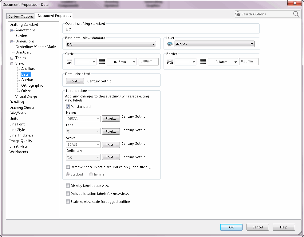

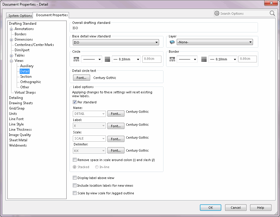

Document Properties > Views > Detail
Setting
Get/Set Methods
Return Value or <Value>
Comments
Base detail view standard
IModelDocExtension::GetUserPreferenceInteger(swUserPreferenceIntegerValue_e.swDetailingDimensionStandard, swUserPreferenceOption_e.swDetailingDetailView)
IModelDocExtension::SetUserPreferenceInteger(swUserPreferenceIntegerValue_e.swDetailingDimensionStandard, swUserPreferenceOption_e.swDetailingDetailView, swDetailingStandard_e.<Value>)
See swDetailingStandard_e for valid options
Specifies the base detail view standard to use
Circle - Line Style
IModelDocExtension::GetUserPreferenceInteger(swUserPreferenceIntegerValue_e.swLineFontDetailCircleStyle, swUserPreferenceOption_e.swDetailingDetailView)
IModelDocExtension::SetUserPreferenceInteger(swUserPreferenceIntegerValue_e.swLineFontDetailCircleStyle, swUserPreferenceOption_e.swDetailingDetailView, swLineStyles_e.<Value>)
See swLineStyles_e for valid options
Specifies the line style of detail view circles
Circle - Line Thickness
IModelDocExtension::GetUserPreferenceInteger(swUserPreferenceIntegerValue_e.swLineFontDetailCircleThickness, swUserPreferenceOption_e.swDetailingDetailView)
IModelDocExtension::SetUserPreferenceInteger(swUserPreferenceIntegerValue_e.swLineFontDetailCircleThickness, swUserPreferenceOption_e.swDetailingDetailView, swLineWeights_e.<Value>)
See swLineWeights_e for valid options
Specifies the line thickness of detail view circles
Circle - Custom thickness
IModelDocExtension::GetUserPreferenceDouble(swUserPreferenceDoubleValue_e.swLineFontDetailCircleThicknessCustom, swUserPreferenceOption_e.swDetailingDetailView)
IModelDocExtension::SetUserPreferenceDouble(swUserPreferenceDoubleValue_e.swLineFontDetailCircleThicknessCustom, swUserPreferenceOption_e.swDetailingDetailView, <Value>)
Double value
Specifies custom thickness of lines for detail view circles; sets Custom Thickness to the specified thickness and Leader Thickness to Custom Size
Border - Line Style
IModelDocExtension::GetUserPreferenceInteger(swUserPreferenceIntegerValue_e.swLineFontDetailBorderStyle, swUserPreferenceOption_e.swDetailingDetailView)
IModelDocExtension::SetUserPreferenceInteger(swUserPreferenceIntegerValue_e.swLineFontDetailBorderStyle, swUserPreferenceOption_e.swDetailingDetailView, swLineStyles_e.<Value>)
Specifies style of detail view border
Border - Line Thickness
IModelDocExtension::GetUserPreferenceInteger(swUserPreferenceIntegerValue_e.swLineFontDetailBorderThickness, swUserPreferenceOption_e.swDetailingDetailView)
IModelDocExtension::SetUserPreferenceInteger(swUserPreferenceIntegerValue_e.swLineFontDetailBorderThickness, swUserPreferenceOption_e.swDetailingDetailView, swLineWeights_e.<Value>)
Specifies thickness of detail view border
Border - Custom thickness
IModelDocExtension::GetUserPreferenceDouble(swUserPreferenceDoubleValue_e.swLineFontDetailBorderThicknessCustom, swUserPreferenceOption_e.swDetailingDetailView)
IModelDocExtension::SetUserPreferenceDouble(swUserPreferenceDoubleValue_e.swLineFontDetailBorderThicknessCustom, swUserPreferenceOption_e.swDetailingDetailView, <Value>)
Double value
Specifies custom thickness of detail view border lines; sets Custom Thickness to the specified thickness and Leader Thickness to Custom Size
Detail circle text - Font
IModelDocExtension::GetUserPreferenceTextFormat(swUserPreferenceTextFormat_e.swDetailingDetailTextFormat, swUserPreferenceOption_e.swDetailingDetailView)
IModelDocExtension::SetUserPreferenceTextFormat(swUserPreferenceTextFormat_e.swDetailingDetailTextFormat, swUserPreferenceOption_e.swDetailingDetailView, <Value>)
See ITextFormat for font options
To set font property values, implement ITextFormat, set the appropriate ITextFormat member values, and pass the ITextFormat object in the API set method
Label options - Per standard
IModelDocExtension::GetUserPreferenceToggle(swUserPreferenceToggle_e.swDetailingDetailViewLabels_PerStandard, swUserPreferenceOption_e.swDetailingDetailView)
IModelDocExtension::SetUserPreferenceToggle(swUserPreferenceToggle_e.swDetailingDetailViewLabels_PerStandard, swUserPreferenceOption_e.swDetailingDetailView, <Value>)
Boolean value
If...
Then display the detail view label according to the format...
True
Required by the current detailing standard
False
Determined by these document-level user preferences:
swDetailingDetailViewLabels_Name
swDetailingDetailViewLabels_Label
swDetailingDetailViewLabels_Scale
swDetailingDetailViewLabels_Delimiter
Label options - Name
IModelDocExtension::GetUserPreferenceInteger(swUserPreferenceIntegerValue_e.swDetailingDetailViewLabels_Name, swUserPreferenceOption_e.swDetailingDetailView)
IModelDocExtension::SetUserPreferenceInteger(swUserPreferenceIntegerValue_e.swDetailingDetailViewLabels_Name, swUserPreferenceOption_e.swDetailingDetailView, swDetailingViewLabelsName_e.<Value>)
See swDetailingViewLabelsName_e for valid options
Specifies the label to use in front of the detail view; if set to swDetailingViewLabelsName_e.swDetailingViewLabelsName_custom, then set Label options - Name (CUSTOM) to a custom label
IModelDocExtension::GetUserPreferenceString(swUserPreferenceStringValue_e.swDetailingDetailViewLabels_CustomName, swUserPreferenceOption_e.swDetailingDetailView)
IModelDocExtension::SetUserPreferenceString(swUserPreferenceStringValue_e.swDetailingDetailViewLabels_CustomName, swUserPreferenceOption_e.swDetailingDetailView, <Value>)
String value
Specifies the custom label to use in front of the detail view; valid only if Label options - Name is set to swDetailingViewLabelsName_e.swDetailingViewLabelsName_custom
Label options - Name - Font
IModelDocExtension::GetUserPreferenceTextFormat(swUserPreferenceTextFormat_e.swDetailingDetailView_NameTextFormat, swUserPreferenceOption_e.swDetailingDetailView)
IModelDocExtension::SetUserPreferenceTextFormat(swUserPreferenceTextFormat_e.swDetailingDetailView_NameTextFormat, swUserPreferenceOption_e.swDetailingDetailView, <Value>)
Label options - Label
IModelDocExtension::GetUserPreferenceInteger(swUserPreferenceIntegerValue_e.swDetailingDetailViewLabels_Label, swUserPreferenceOption_e.swDetailingDetailView)
IModelDocExtension::SetUserPreferenceInteger(swUserPreferenceIntegerValue_e.swDetailingDetailViewLabels_Label, swUserPreferenceOption_e.swDetailingDetailView, swDetailingViewLabelsLabel_e.<Value>)
See swDetailingViewLabelsLabel_e for valid options
Specifies the format of the detail view label
Label options - Label - Font
IModelDocExtension::GetUserPreferenceTextFormat(swUserPreferenceTextFormat_e.swDetailingDetailView_LabelTextFormat, swUserPreferenceOption_e.swDetailingDetailView)
IModelDocExtension::SetUserPreferenceTextFormat(swUserPreferenceTextFormat_e.swDetailingDetailView_LabelTextFormat, swUserPreferenceOption_e.swDetailingDetailView, <Value>)
Label options - Scale
IModelDocExtension::GetUserPreferenceInteger(swUserPreferenceIntegerValue_e.swDetailingDetailViewLabels_Scale, swUserPreferenceOption_e.swDetailingDetailView)
IModelDocExtension::SetUserPreferenceInteger(swUserPreferenceIntegerValue_e.swDetailingDetailViewLabels_Scale, swUserPreferenceOption_e.swDetailingDetailView, swDetailingViewLabelsScale_e.<Value>)
See swDetailingViewLabelsScale_e for valid options
Specifies the label to use in front of the scale value; if set to swDetailingViewLabelsScale_e.swDetailingViewLabelsScale_SCALEcustom, then set Label options - Scale (CUSTOM) to a custom scale label
IModelDocExtension::GetUserPreferenceString(swUserPreferenceStringValue_e.swDetailingDetailViewLabels_CustomScale, swUserPreferenceOption_e.swDetailingDetailView)
IModelDocExtension::SetUserPreferenceString(swUserPreferenceStringValue_e.swDetailingDetailViewLabels_CustomScale, swUserPreferenceOption_e.swDetailingDetailView, <Value>)
String value
Specifies the custom label to use in front of the scale value; valid only if Label options - Scale is set to swDetailingViewLabelsScale_e.swDetailingViewLabelsScale_SCALEcustom
Label options - Scale - Font
IModelDocExtension::GetUserPreferenceTextFormat(swUserPreferenceTextFormat_e.swDetailingDetailView_ScaleTextFormat, swUserPreferenceOption_e.swDetailingDetailView)
IModelDocExtension::SetUserPreferenceTextFormat(swUserPreferenceTextFormat_e.swDetailingDetailView_ScaleTextFormat, swUserPreferenceOption_e.swDetailingDetailView, <Value>)
Label options - Delimiter
IModelDocExtension::GetUserPreferenceInteger(swUserPreferenceIntegerValue_e.swDetailingDetailViewLabels_Delimiter, swUserPreferenceOption_e.swDetailingDetailView)
IModelDocExtension::SetUserPreferenceInteger(swUserPreferenceIntegerValue_e.swDetailingDetailViewLabels_Delimiter, swUserPreferenceOption_e.swDetailingDetailView, swDetailingViewLabelsDelimiter_e .<Value>)
See swDetailingViewLabelsDelimiter_e for valid options
Specifies the format of the scale value
Label options - Delimiter - Font
IModelDocExtension::GetUserPreferenceTextFormat(swUserPreferenceTextFormat_e.swDetailingDetailView_DelimiterTextFormat, swUserPreferenceOption_e.swDetailingDetailView)
IModelDocExtension::SetUserPreferenceTextFormat(swUserPreferenceTextFormat_e.swDetailingDetailView_DelimiterTextFormat, swUserPreferenceOption_e.swDetailingDetailView, <Value>)
Label options - Remove space in scale around colon (:) and slash (/)
IModelDocExtension::GetUserPreferenceToggle(swUserPreferenceToggle_e.swDetailingDetailView_RemoveSpaceInScale, swUserPreferenceOption_e.swDetailingDetailView)
IModelDocExtension::SetUserPreferenceToggle(swUserPreferenceToggle_e.swDetailingDetailView_RemoveSpaceInScale, swUserPreferenceOption_e.swDetailingDetailView, <Value>)
Boolean value
Specifies whether to remove spaces around the delimiter in the scale text
Stacked or In-line
IModelDocExtension::GetUserPreferenceToggle(swUserPreferenceToggle_e.swDetailingDetailViewLabels_Stacked, swUserPreferenceOption_e.swDetailingDetailView)
IModelDocExtension::SetUserPreferenceToggle(swUserPreferenceToggle_e.swDetailingDetailViewLabels_Stacked, swUserPreferenceOption_e.swDetailingDetailView, <Value>)
Boolean value
If...
Then display the detail view name and scale in...
True
2 lines
False
1 line
Display label above view
IModelDocExtension::GetUserPreferenceToggle(swUserPreferenceToggle_e.swDetailingDetailViewLabels_AboveView, swUserPreferenceOption_e.swDetailingDetailView)
IModelDocExtension::SetUserPreferenceToggle(swUserPreferenceToggle_e.swDetailingDetailViewLabels_AboveView, swUserPreferenceOption_e.swDetailingDetailView, <Value>)
Boolean value
Specifies whether to show label above detail view
Include location labels for new views
IModelDocExtension::GetUserPreferenceToggle(swUserPreferenceToggle_e.swDetailingDetailView_IncludeLocationLabelsForNewViews, swUserPreferenceOption_e.swDetailingDetailView)
IModelDocExtension::SetUserPreferenceToggle(swUserPreferenceToggle_e.swDetailingDetailView_IncludeLocationLabelsForNewViews, swUserPreferenceOption_e.swDetailingDetailView, <Value>)
Boolean value
Specifies whether to include location labels for new detail views
Scale by view scale for Jagged outline
IModelDocExtension::GetUserPreferenceToggle(swUserPreferenceToggle_e.swDetailingDetailViewLabels_ScaleForJaggedOutline, swUserPreferenceOption_e.swDetailingDetailView)
IModelDocExtension::SetUserPreferenceToggle(swUserPreferenceToggle_e.swDetailingDetailViewLabels_ScaleForJaggedOutline, swUserPreferenceOption_e.swDetailingDetailView, <Value>)
Boolean value
Specifies whether to scale the Jagged outline using the view scale
Layer
IModelDocExtension::GetUserPreferenceString(swUserPreferenceStringValue_e.swDetailingLayer, swUserPreferenceOption_e.swDetailingDetailView)
IModelDocExtension::SetUserPreferenceString(swUserPreferenceStringValue_e.swDetailingLayer, swUserPreferenceOption_e.swDetailingDetailView, <Value>)
Valid Options:
  • "Border"
  • "Dimensions"
  • "Notes"
  • "BOM"
  • "FORMAT"
This setting is available only on drawings; depending on drawing, some options may not apply
