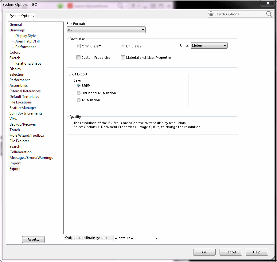

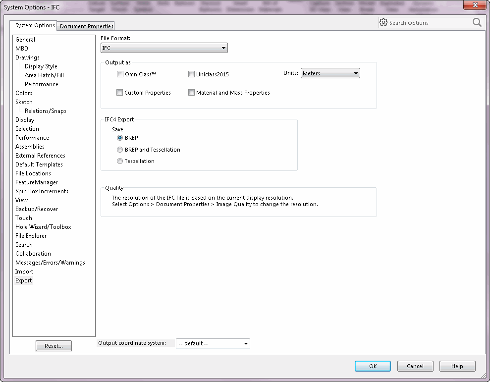

System Options > Export > IFC
This topic contains two tables. The information in the table:
  • appearing immediately after the dialog corresponds to the settings on that dialog.
  • titled Obsolete Enumerators contains enumerators that previously appeared on the dialog but are now obsolete.
To display the dialog:
Click Tools > Options > System Options > Export > IFC in File Format.
- or -
  1. Click File > Save As.
  2. In Save as type, select IFC 2x3 or IFC 4.
  3. Click Options.
Setting
Get/Set Methods
Return Value
or
<Value>
or
<OnFlag>
Comment
Output as - OmniClass
ISldWorks::GetUserPreferenceToggle(swUserPreferenceToggle_e.swIFCOmniClassPreference)
ISldWorks::SetUserPreferenceToggle(swUserPreferenceToggle_e.swIFCOmniClassPreference, <OnFlag>)
Boolean value
Output as - UniClass2
ISldWorks::GetUserPreferenceToggle(swUserPreferenceToggle_e.swIFCUniClass2Preference)
ISldWorks::SetUserPreferenceToggle(swUserPreferenceToggle_e.swIFCUniClass2Preference, <OnFlag>)
Boolean value
Output as - Custom Properties
ISldWorks::GetUserPreferenceToggle(swUserPreferenceToggle_e.swIFCCustomPropsPreference)
ISldWorks::SetUserPreferenceToggle(swUserPreferenceToggle_e.swIFCCustomPropsPreference, <OnFlag>)
Boolean value
Output as - Material and Mass Properties
ISldWorks::GetUserPreferenceToggle(swUserPreferenceToggle_e.swIFCMaterialsMassPropertiesPreference)
ISldWorks::SetUserPreferenceToggle(swUserPreferenceToggle_e.swIFCMaterialsMassPropertiesPreference, <OnFlag>)
Boolean value
Output as - Units
ISldWorks::GetUserPreferenceIntegerValue(swUserPreferenceIntegerValue_e.swExportIFCUnits)
ISldWorks::SetUserPreferenceIntegerValue(swUserPreferenceIntegerValue_e.swExportIFCUnits, swLengthUnit_e.<Value>)
Any of the following swLengthUnit_e values:
  • 0 = swMM (millimeters)
  • 1 = swCM (centimeters)
  • 2 = swMETER
  • 3 = swINCHES
  • 4 = swFEET
IFC4 Export - Save - BREP,  BREP and Tessellation, or Tessellation
ISldWorks::GetUserPreferenceIntegerValue(swUserPreferenceIntegerValue_e.swIFCExportSaveType)
ISldWorks::SetUserPreferenceIntegerValue(swUserPreferenceIntegerValue_e.swIFCExportSaveType, swIFCExportSaveType_e.<Value>)
See swIFCExportSaveType_e for valid options
