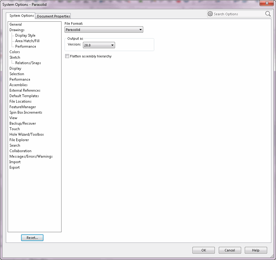

System Options > Export > Parasolid
This topic contains two tables. The information in the table:
  • appearing immediately after the screen capture corresponds to the settings on that dialog.
  • titled Obsolete Enumerators contains enumerators that previously appeared on the dialog but are now obsolete.
To display the dialog:
Click Tools > Options > System Options > Export > Parasolid in File Format.
- or -
  1. Click File > Save As.
  2. In Save as type, select Parasolid or Parasolid Binary.
  3. Click Options.
Setting
Get/Set Methods
Return Value
or
<Value>
or
<OnFlag>
Comment
Output as - Version
ISldWorks::GetUserPreferenceIntegerValue(swUserPreferenceIntegerValue_e.swParasolidOutputVersion)
ISldWorks::SetUserPreferenceIntegerValue(swUserPreferenceIntegerValue_e.swParasolidOutputVersion, swParasolidOutputVersion_e.<Value>)
See swParasolidOutputVersion_e for valid options
Flatten assembly hierarchy
ISldWorks::GetUserPreferenceToggle(swUserPreferenceToggle_e.swXTAssemSaveFormat)
ISldWorks::SetUserPreferenceToggle(swUserPreferenceToggle_e.swXTAssemSaveFormat, <OnFlag>)
Boolean value
Specifies whether to flatten assembly hierarchy in Parasolid output; for assemblies only

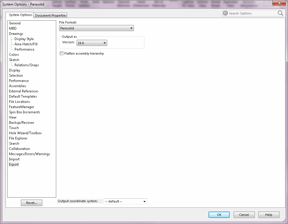

Enumerator
Comment
swFileSaveAsCoordinateSystem
Obsolete
