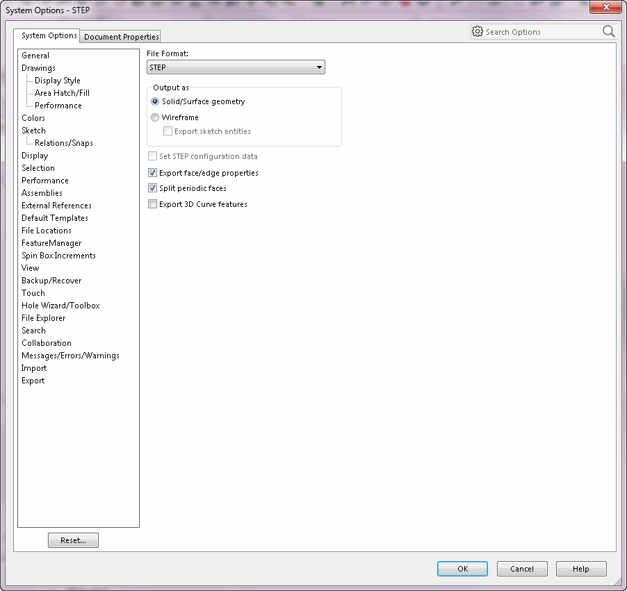

System Options > Export > STEP
This topic contains two tables. The information in the table:
  • appearing immediately after the screen capture corresponds to the settings on that dialog.
  • titled Miscellaneous Enumerators contains enumerators related to saving STEP data.
  • titled Obsolete Enumerators contains enumerators that previously appeared on the dialog but are now obsolete.
To display the dialog:
Click Tools > Options > System Options > Export > STEP in File Format.
- or -
  1. Click File > Save As.
  2. In Save as type, select STEP AP203 or STEP AP214.
  3. Click Options.
