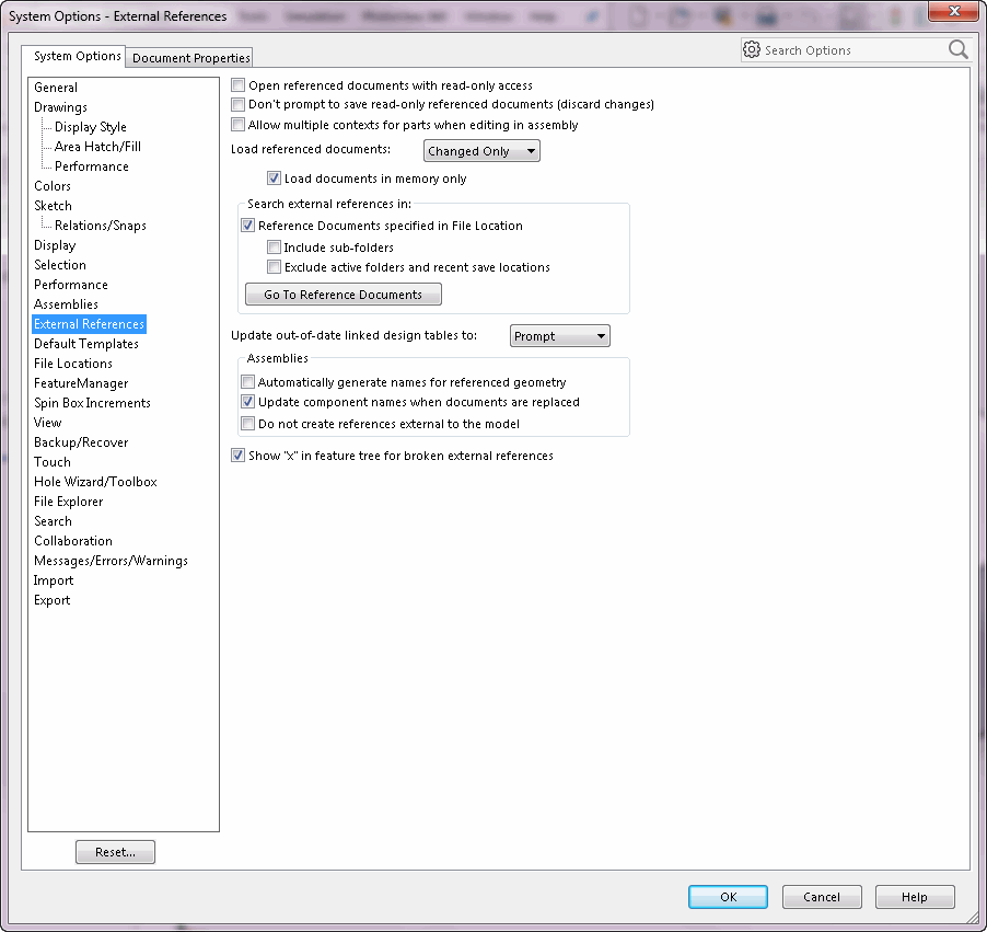

System Options > External References
Setting
Get/Set Methods
Return Value
or
<Value>
or
<OnFlag>
Comment
Open referenced documents with read-only access
ISldWorks::GetUserPreferenceToggle(swUserPreferenceToggle_e.swExtRefOpenReadOnly)
ISldWorks::SetUserPreferenceToggle(swUserPreferenceToggle_e.swExtRefOpenReadOnly, <OnFlag>)
Boolean value
Specifies whether to open referenced documents as read-only
Don't prompt to save read-only referenced documents (discard changes)
ISldWorks::GetUserPreferenceToggle(swUserPreferenceToggle_e.swExtRefNoPromptOrSave)
ISldWorks::SetUserPreferenceToggle(swUserPreferenceToggle_e.swExtRefNoPromptOrSave, <OnFlag>)
Boolean value
Specifies whether to close read-only reference documents without prompting or attempting to save changes made to them when saving or closing the parent document
Allow multiple contexts for parts when editing in assembly
ISldWorks::GetUserPreferenceToggle(swUserPreferenceToggle_e.swExtRefMultipleContexts)
ISldWorks::SetUserPreferenceToggle(swUserPreferenceToggle_e.swExtRefMultipleContexts, <OnFlag>)
Boolean value
Specifies whether to create external references to a single part from more than one assembly context
Load referenced documents
ISldWorks::GetUserPreferenceIntegerValue(swUserPreferenceIntegerValue_e.swLoadExternalReferences)
ISldWorks::SetUserPreferenceIntegerValue(swUserPreferenceIntegerValue_e.swLoadExternalReferences, swLoadExternalReferences_e.<Value>)
See swLoadExternalReferences_e for valid options
Load documents in memory only
ISldWorks::GetUserPreferenceToggle(swUserPreferenceToggle_e.swExtRefLoadRefDocsInMemory)
ISldWorks::SetUserPreferenceToggle(swUserPreferenceToggle_e.swExtRefLoadRefDocsInMemory, <OnFlag>)
Boolean value
Specifies whether to load reference documents in memory only
Search external references in - Reference Documents specified in File Location
ISldWorks::GetUserPreferenceToggle(swUserPreferenceToggle_e.swUseFolderSearchRules)
ISldWorks::SetUserPreferenceToggle(swUserPreferenceToggle_e.swUseFolderSearchRules, <OnFlag>)
Boolean value
Specifies whether to search the Referenced Documents list of folders in the File Locations Options dialog
Search external references in - Reference Documents specified in File Location - Include sub-folders
ISldWorks::GetUserPreferenceToggle(swUserPreferenceToggle_e.swExtRefIncludeSubFolders)
ISldWorks::SetUserPreferenceToggle(swUserPreferenceToggle_e.swExtRefIncludeSubFolders, <OnFlag>)
Boolean value
Specifies whether to search for reference documents in sub-folders in the specified file location; valid only if Reference Documents specified in File Location is true
Search external references in - Reference Documents specified in File Location - Exclude active folders and recent save locations
ISldWorks::GetUserPreferenceToggle(swUserPreferenceToggle_e.swExtRefExcludeActiveFoldersAndRecentSaveLocations)
ISldWorks::SetUserPreferenceToggle(swUserPreferenceToggle_e.swExtRefExcludeActiveFoldersAndRecentSaveLocations, <OnFlag>)
Boolean value
Specifies whether to block searching for reference documents in open folders and folders containing recently saved items; valid only if Reference Documents specified in File Location is true
Update out-of-date linked design tables to
ISldWorks::GetUserPreferenceIntegerValue(swUserPreferenceIntegerValue_e.swExternalReferencesUpdateOutOfDateLinkedDesignTable)
ISldWorks::SetUserPreferenceIntegerValue(swUserPreferenceIntegerValue_e.swExternalReferencesUpdateOutOfDateLinkedDesignTable, swExternalReferencesUpdateOutOfDateLinkedDesignTable_e.<Value>)
See swExternalReferencesUpdateOutOfDateLinkedDesignTable_e for valid options
Assemblies - Automatically generate names for referenced geometry
ISldWorks::GetUserPreferenceToggle(swUserPreferenceToggle_e.swExtRefAutoGenNames)
ISldWorks::SetUserPreferenceToggle(swUserPreferenceToggle_e.swExtRefAutoGenNames, <OnFlag>)
Boolean value
Specifies whether to automatically generate names for referenced geometry
Assemblies - Update component names when documents are replaced
ISldWorks::GetUserPreferenceToggle(swUserPreferenceToggle_e.swExtRefUpdateCompNames)
ISldWorks::SetUserPreferenceToggle(swUserPreferenceToggle_e.swExtRefUpdateCompNames, <OnFlag>)
Boolean value
Specifies whether to mate to read-only parts using internal face IDs of the parts or to replace components using surface identifiers to write-access parts
Assemblies - Do not create references external to the model
ISldWorks::GetUserPreferenceToggle(swUserPreferenceToggle_e.swExternalReferencesDisable)
ISldWorks::SetUserPreferenceToggle(swUserPreferenceToggle_e.swExternalReferencesDisable, <OnFlag>)
Boolean value
Specifies whether to create external references when designing in the context of an assembly
Show "x" in feature tree for broken external references
ISldWorks::GetUserPreferenceToggle(swUserPreferenceToggle_e.swExtRefShowXInFeatureTree)
ISldWorks::SetUserPreferenceToggle(swUserPreferenceToggle_e.swExtRefShowXInFeatureTree, <OnFlag>)
Boolean value
Specifies whether to hide or show the x that appears in the FeatureManager design tree to indicate broken references
