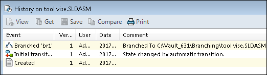

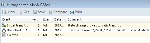

History of branched file |
History of source file |
