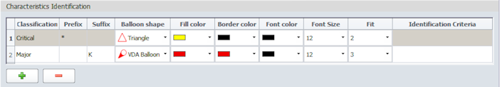

Predefining Balloon Appearances
In Project Options, under Ballooning, you can use the Characteristic Identification feature to predefine unique balloon appearances for special characteristics for easy identification when performing an inspection.
The Characteristic Identification feature can be applied to Key Characteristics. Therefore, the Key Characteristics options Identified and Placement have been eliminated.
