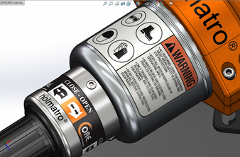

SOLIDWORKS Visualize 2018 introduces an all new decal system, providing several key improvements and new functionality.
Support of all SOLIDWORKS Decal Types
Cylindrical
Maps all points onto a cylinder
Spherical
Maps all points onto a sphere
Planar/Projection
Maps all points onto a specified plane and then projects the decal onto the reference entity
Label
Maps decals onto the model faces, including multiple contiguous nonplanar surfaces with no stretching or shrinking

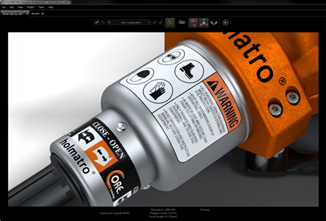

Animation Keyframe Support
You can create unique decal animations by right-clicking a decal and clicking Add Keyframe. You can scale and position decals. In addition, you can animate the Opacity (visibility) to show items such as multiple decal options, slide shows, flashing billboards, and flickering TV screens.
Additional Key Improvements
  • Floating decal issues, with noticeable drop shadow, are resolved
  • Improved overall performance and files with many decals are handled properly
  • No limit on the number of decals per project/part
  • Support for up to 6 overlapping decals on a single part
