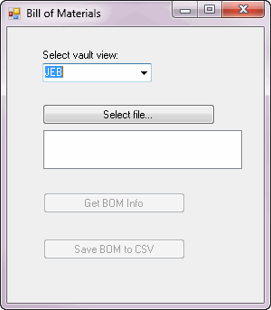

' Postconditions:
' 1. Opens the Bill of Materials dialog box.
'    a. Select a vault_name view.
'    b. Click Select file.
'    c. In the Select File dialog:
'       1. Click the assembly specified in Preconditions step 5.
'       2. Click Open.
'    d. Click Get BOM Info.
'       Displays message boxes containing:
'       * Information about all named BOMs of the assembly.
'       * Version information for the named BOMs.
'       * Information about all BOM layouts in the vault.
'       * Row and column information about a BOM view in the BOM layout
'         for the selected assembly in its @ configuration.
'    e. Click OK in each message box.
'    f. Click Save BOM to CSV.
'       Saves the BOM to c:\temp\SavedBOM.csv.
' 2. Close the Bill of Materials dialog box.
' 3. Verify that c:\temp\SavedBOM.csv is created.

        Me.SelectFiles.Name = "SelectFiles"
        Me.SelectFiles.Size = New System.Drawing.Size(191, 23)
        Me.SelectFiles.TabIndex = 2
        Me.SelectFiles.Text = "Select file..."
        Me.SelectFiles.UseVisualStyleBackColor = True
        'File1List
        Me.File1List.FormattingEnabled = True
        Me.File1List.HorizontalScrollbar = True
        Me.File1List.Location = New System.Drawing.Point(40, 114)
        Me.File1List.Name = "File1List"
        Me.File1List.SelectionMode = System.Windows.Forms.SelectionMode.MultiExtended
        Me.File1List.Size = New System.Drawing.Size(220, 43)
        Me.File1List.TabIndex = 4
        'GetBOM
        Me.GetBOM.Enabled = False
        Me.GetBOM.Location = New System.Drawing.Point(40, 183)
        Me.GetBOM.Name = "GetBOM"
        Me.GetBOM.Size = New System.Drawing.Size(157, 23)
        Me.GetBOM.TabIndex = 6
        Me.GetBOM.Text = "Get BOM Info"
        Me.GetBOM.UseVisualStyleBackColor = True
        'OpenFileDialog1
        Me.OpenFileDialog1.FileName = "OpenFileDialog1"
        Me.OpenFileDialog1.Title = "Select File"
        'SaveBOM
        Me.SaveBOM.Enabled = False
        Me.SaveBOM.Location = New System.Drawing.Point(40, 234)
        Me.SaveBOM.Name = "SaveBOM"
        Me.SaveBOM.Size = New System.Drawing.Size(157, 23)
        Me.SaveBOM.TabIndex = 7
        Me.SaveBOM.Text = "Save BOM to CSV"
        Me.SaveBOM.UseVisualStyleBackColor = True
        'Form1
        Me.AutoScaleDimensions = New System.Drawing.SizeF(6.0!, 13.0!)
        Me.AutoScaleMode = System.Windows.Forms.AutoScaleMode.Font
        Me.ClientSize = New System.Drawing.Size(284, 305)
        Me.Controls.Add(Me.SaveBOM)
        Me.Controls.Add(Me.GetBOM)
        Me.Controls.Add(Me.File1List)
        Me.Controls.Add(Me.SelectFiles)
        Me.Controls.Add(Me.VaultsComboBox)
        Me.Controls.Add(Me.VaultsLabel)
        Me.Name = "Form1"
        Me.Text = "Bill of Materials"
        Me.ResumeLayout(False)
        Me.PerformLayout()
    End Sub
    Friend WithEvents VaultsLabel As System.Windows.Forms.Label
    Friend WithEvents VaultsComboBox As System.Windows.Forms.ComboBox
    Friend WithEvents SelectFiles As System.Windows.Forms.Button
    Friend WithEvents File1List As System.Windows.Forms.ListBox
    Friend WithEvents GetBOM As System.Windows.Forms.Button
    Friend WithEvents OpenFileDialog1 As System.Windows.Forms.OpenFileDialog
    Friend WithEvents SaveBOM As Button
End Class
