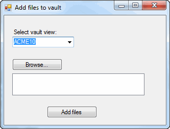

' Postconditions:
' 1. Displays the Add files to vault dialog box.
'    a. Select a vault view.
'    b. Click Browse
'       1. Locate and click three files outside the vault.
'       2. Click Open.
'    c. Click Add files.
'       1. Adds the selected files to the root folder of the vault.
'       2. Checks in the files.
'       3. Creates path \temp\files in the root folder.
'       4. Moves one of the files to subfolder \temp\files.
'       5. Copies one of the files to subfolder \temp.
'       6. Changes the state of one of the files in the root folder to
'          Waiting for Approval.
' 2. Click OK to close each message box.
' 3. Examine the vault.
' 4. Close the Add files to vault dialog box.

        Me.ListBox.Name = "ListBox"
        Me.ListBox.SelectionMode = System.Windows.Forms.SelectionMode.MultiExtended
        Me.ListBox.Size = New System.Drawing.Size(259, 43)
        Me.ListBox.TabIndex = 4
        'AddFiles
        Me.AddFiles.Location = New System.Drawing.Point(84, 178)
        Me.AddFiles.Name = "AddFiles"
        Me.AddFiles.Size = New System.Drawing.Size(98, 23)
        Me.AddFiles.TabIndex = 5
        Me.AddFiles.Text = "Add files"
        Me.AddFiles.UseVisualStyleBackColor = True
        'OpenFileDialog
        Me.OpenFileDialog.Multiselect = True
        Me.OpenFileDialog.Title = "Open"
        'Form1
        Me.AutoScaleDimensions = New System.Drawing.SizeF(6.0!, 13.0!)
        Me.AutoScaleMode = System.Windows.Forms.AutoScaleMode.Font
        Me.ClientSize = New System.Drawing.Size(317, 215)
        Me.Controls.Add(Me.AddFiles)
        Me.Controls.Add(Me.ListBox)
        Me.Controls.Add(Me.BrowseButton)
        Me.Controls.Add(Me.VaultsComboBox)
        Me.Controls.Add(Me.VaultsLabel)
        Me.Name = "Form1"
        Me.Text = "Add files to vault"
        Me.ResumeLayout(False)
        Me.PerformLayout()
    End Sub
#End Region
    Friend WithEvents VaultsLabel As System.Windows.Forms.Label
    Friend WithEvents VaultsComboBox As System.Windows.Forms.ComboBox
    Friend WithEvents BrowseButton As System.Windows.Forms.Button
    Friend WithEvents ListBox As System.Windows.Forms.ListBox
    Friend WithEvents AddFiles As System.Windows.Forms.Button
    Friend WithEvents OpenFileDialog As System.Windows.Forms.OpenFileDialog
End Class
