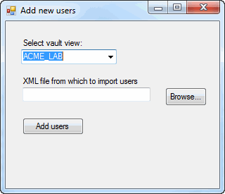

// f. Create a form similar to the form shown above and change:
// 1. Top label to VaultsLabel.
// 2. Combo box to VaultsCombobox.
// 3. Second label to XmlLabel.
// 4. Text box to XmlTextBox.
// 5. Browse button to BrowseButton.
// 6. Add users button to AddUsersButton.

// 1. Displays a dialog.
// 2. Select a vault.
// 3. Click Browse, locate and select User.xml, and click Open.
// 4. Click Add users.
// A message box is displayed showing the names of the new users added
// to the vault.
// 5. Click OK to close the message box.
// 6. Close the dialog.

this.AutoScaleMode = System.Windows.Forms.AutoScaleMode.Font;
this.ClientSize = new System.Drawing.Size(284, 262);
this.Controls.Add(this.AddUsersButton);
this.Controls.Add(this.BrowseButton);
this.Controls.Add(this.XmlTextBox);
this.Controls.Add(this.XmlLabel);
this.Controls.Add(this.VaultsComboBox);
this.Controls.Add(this.VaultsLabel);
this.Name = "Form1";
this.Text = "Add new users";
this.Load += new System.EventHandler(this.AddUsers_Load);
this.ResumeLayout(false);
this.PerformLayout();
#endregion
private System.Windows.Forms.Label VaultsLabel;
private System.Windows.Forms.ComboBox VaultsComboBox;
private System.Windows.Forms.Label XmlLabel;
private System.Windows.Forms.TextBox XmlTextBox;
private System.Windows.Forms.Button BrowseButton;
private System.Windows.Forms.Button AddUsersButton;
private System.Windows.Forms.OpenFileDialog XmlOpenFileDialog;
