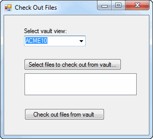

' Postconditions:
'  1. The Check Out Files dialog box displays.
'     a. Select a vault view.
'     b. Click Select files to check out from vault.
'     c. In the Select File dialog:
'        1. Click a couple of files inside the vault.
'        2. Click Open.
'     d. Click Check out files from vault.
'  2. Click Check Out in the Check Out dialog box.
'  3. Close the Check Out Files dialog box.
'  4. Observe that the selected files are checked out of the selected vault.
