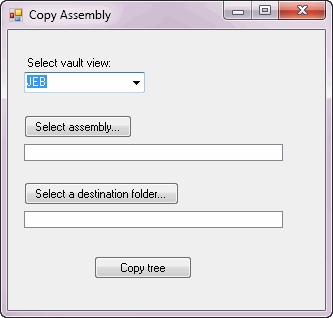

// Postconditions:
// 1. Displays the Copy Assembly dialog box.
//    a. Select a vault view.
//    b. Click Select assembly
//       Locate and double-click an assembly.
//    c. Click Select a destination folder.
//       1. Locate and select New Folder.
//       2. Click OK.
//    d. Click Copy tree.
//       The Copy Tree dialog shows the files to copy.
//    e. Click Copy
//       The Copying tree progress bar appears.
//    f. Inspect the destination folder.
// 2. Close the Copy Assembly dialog box.

            this.listBox1.TabIndex = 7;
            // Form1
            this.AutoScaleDimensions = new System.Drawing.SizeF(6F, 13F);
            this.AutoScaleMode = System.Windows.Forms.AutoScaleMode.Font;
            this.ClientSize = new System.Drawing.Size(317, 363);
            this.Controls.Add(this.listBox1);
            this.Controls.Add(this.BrowseDestFolder);
            this.Controls.Add(this.CopyTree);
            this.Controls.Add(this.ListBox);
            this.Controls.Add(this.BrowseAssembly);
            this.Controls.Add(this.VaultsComboBox);
            this.Controls.Add(this.VaultsLabel);
            this.Name = "Form1";
            this.Text = "Copy Assembly";
            this.Load += new System.EventHandler(this.Form1_Load);
            this.ResumeLayout(false);
            this.PerformLayout();
        #endregion
        internal System.Windows.Forms.Label VaultsLabel;
        internal System.Windows.Forms.ComboBox VaultsComboBox;
        internal System.Windows.Forms.Button BrowseAssembly;
        internal System.Windows.Forms.ListBox ListBox;
        internal System.Windows.Forms.Button CopyTree;
        internal System.Windows.Forms.OpenFileDialog OpenFileDialog;
        internal System.Windows.Forms.Button BrowseDestFolder;
        internal System.Windows.Forms.ListBox listBox1;
