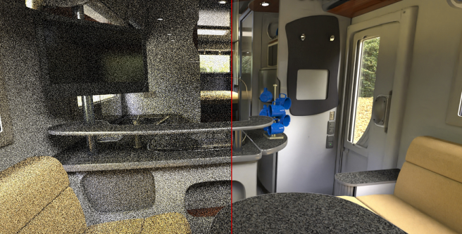

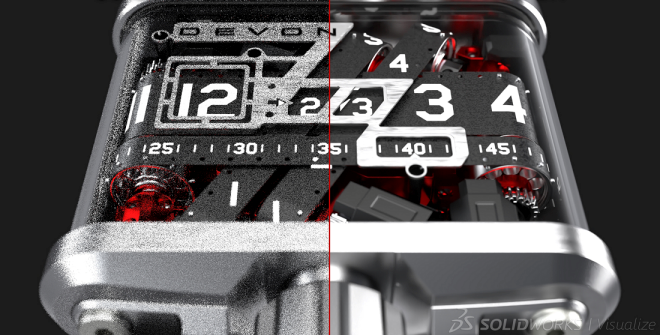

The Denoiser is a post processing technique based on machine learning that filters out the noise from unfinished and noisy images produced with Fast and Accurate render modes.
Although denoising costs some GPU performance, it significantly (depending on the nature of the scene and computer hardware) improves the time to render production quality images with SOLIDWORKS Visualize.
To prevent a negative impact of the Denoiser on the interactivity of the application, it is not applied until after the 10th accumulated render pass.
