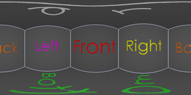

The 360 lens is a nonlinear type of projection that captures the whole 360° environment around the camera’s position into a single wide screen image. The result displays in a Lat/Long or Equirectangular image that resembles a photo with an extreme fish eye lens.
In this example, two images of an interior scene are created from the same camera position using Perspective and 360 projections.
Perspective
360
