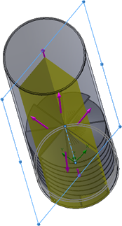

You can simulate sector periodicity problems, including rotation and heat
conduction in solids.
Phase transitions (including
isothermal cavitation), high Mach number flows, and mixing plane rotation regions are
not allowed. When performing the simulation, the rotation axis should be parallel to one
of the global coordinate system axes.
