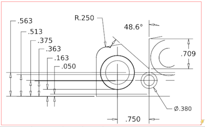

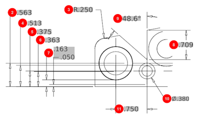

To extract characteristics,
click
Smart Extract (CommandManager) or right-click and click

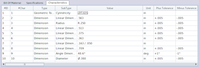

Smart Extract. You can extract a single characteristic or
multiple characteristics.
![](qid1490277681700.image)
This is useful for extracting GD&T without manually recognizing each element.
