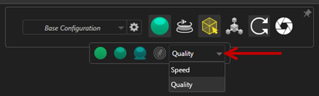

Fast Raytracing Mode Switch
SOLIDWORKS Visualize 2018 includes a
Fast mode toggle
switch:
Speed or
Quality. You can
access this switch from the Main toolbar.
![](bny1493313779021.image)
Speed: Recommended for fastest interactivity in the Viewport.
- This new Fast render setting completes renders
almost two times faster than in previous versions by removing self-shadowing
and time-consuming reflections.
- This is ideal for projects without glass, clear plastics, or transparent
objects.
Quality: Recommended for final renders.
- This new Fast render mode is actually more realistic
and advanced than the previous Fast render mode. This
mode has some of the more photorealistic features found in
Accurate mode, but with the faster raytracing
speeds of Fast mode.
- This new Fast mode allows for a greater usage of
Fast raytracing mode throughout more and more
projects. Accurate raytracing mode is only required for interior
scenes.
