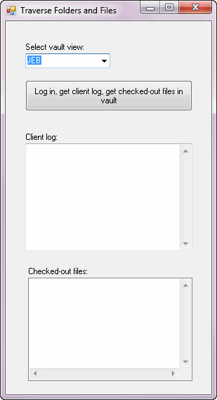

// 1. Displays a Traverse
Folders and Files dialog.
// 2. Select a vault.
// 3. Click Log
in, get client log, get checked-out files in vault.
// 4. Displays a message box with the vault type.
// 5. Click OK.
// 6. Populates Client log and Checked-out files.
// 7. Close the dialog.

this.Text = "Traverse Folders and Files";
this.Load += new System.EventHandler(this.TraverseFilesAndFolders_Load);
