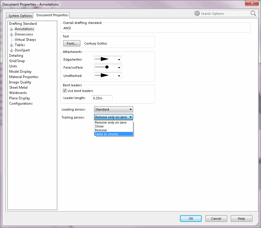

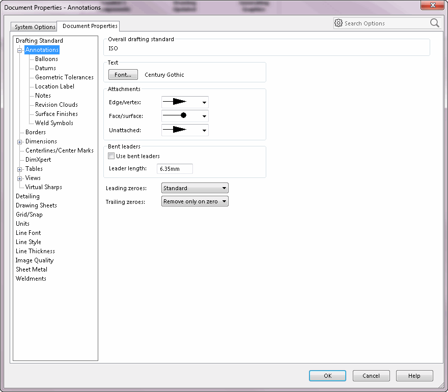

Document Properties > Annotations
Setting
Get/Set Methods
Return Value
or
<Value>
or
<OnFlag>
Comments
Text - Font...
IModelDocExtension::GetUserPreferenceTextFormat(swUserPreferenceTextFormat_e.swDetailingAnnotationTextFormat, swUserPreferenceOption_e.swDetailingNoOptionSpecified)
IModelDocExtension::SetUserPreferenceTextFormat(swUserPreferenceTextFormat_e.swDetailingAnnotationTextFormat, swUserPreferenceOption_e.swDetailingNoOptionSpecified, <Value>)
See ITextFormat for font options
To set font property values, implement ITextFormat, set the appropriate ITextFormat member values, and pass the ITextFormat object in the API set method.
Attachments - Edge/vertex
IModelDocExtension::GetUserPreferenceInteger(swUserPreferenceIntegerValue_e.swDetailingArrowStyleForEdgeVertexAttachment, swUserPreferenceOption_e.swDetailingNoOptionSpecified)
IModelDocExtension::SetUserPreferenceInteger(swUserPreferenceIntegerValue_e.swDetailingArrowStyleForEdgeVertexAttachment, swUserPreferenceOption_e.swDetailingNoOptionSpecified, swArrowStyle_e.<Value>)
See swArrowStyle_e for valid options
Specifies the default style of dimension arrows attached to edges
Attachments - Face/Surface
IModelDocExtension::GetUserPreferenceInteger(swUserPreferenceIntegerValue_e.swDetailingArrowStyleForFaceAttachment, swUserPreferenceOption_e.swDetailingNoOptionSpecified)
IModelDocExtension::SetUserPreferenceInteger(swUserPreferenceIntegerValue_e.swDetailingArrowStyleForFaceAttachment, swUserPreferenceOption_e.swDetailingNoOptionSpecified, swArrowStyle_e.<Value>)
Specifies the default style of dimension arrows attached to faces
Attachments - Unattached
IModelDocExtension::GetUserPreferenceInteger(swUserPreferenceIntegerValue_e.swDetailingArrowStyleForUnattached, swUserPreferenceOption_e.swDetailingNoOptionSpecified)
IModelDocExtension::SetUserPreferenceInteger(swUserPreferenceIntegerValue_e.swDetailingArrowStyleForUnattached, swUserPreferenceOption_e.swDetailingNoOptionSpecified, swArrowStyle_e.<Value>)
Specifies the default style of unattached dimension arrows
Bent leaders - Use bent leaders
IModelDocExtension::GetUserPreferenceToggle(swUserPreferenceToggle_e.swDetailingAnnotationUseBentLeaders, swUserPreferenceOption_e.swDetailingNoOptionSpecified)
IModelDocExtension::SetUserPreferenceToggle(swUserPreferenceToggle_e.swDetailingAnnotationUseBentLeaders, swUserPreferenceOption_e.swDetailingNoOptionSpecified, <OnFlag>)
Boolean value
Specifies whether to use bent leaders for annotations
Bent leaders - Leader length
IModelDocExtension::GetUserPreferenceDouble(swUserPreferenceDoubleValue_e.swDetailingAnnotationBentLeaderLength, swUserPreferenceOption_e.swDetailingNoOptionSpecified)
IModelDocExtension::SetUserPreferenceDouble(swUserPreferenceDoubleValue_e.swDetailingAnnotationBentLeaderLength, swUserPreferenceOption_e.swDetailingNoOptionSpecified, <Value>)
Double value
Specifies the length of the annotation bend leaders in a drawing document
Leading zeroes
IModelDocExtension::GetUserPreferenceInteger(swUserPreferenceIntegerValue_e.swDetailingLeadingZero, swUserPreferenceOption_e.swDetailingAnnotation)
IModelDocExtension::SetUserPreferenceInteger(swUserPreferenceIntegerValue_e.swDetailingLeadingZero, swUserPreferenceOption_e.swDetailingAnnotation, swDetailingLeadingZero_e.<Value>)
See swDetailingLeadingZero_e for valid options
Trailing zeroes
IModelDocExtension::GetUserPreferenceInteger(swUserPreferenceIntegerValue_e.swDetailingDimTrailingZero, swUserPreferenceOption_e.swDetailingAnnotation)
IModelDocExtension::SetUserPreferenceInteger(swUserPreferenceIntegerValue_e.swDetailingDimTrailingZero, swUserPreferenceOption_e.swDetailingAnnotation, swDetailingDimTrailingZero_e.<Value>)
Valid options in swDetailingDimTrailingZero_e:
  • swDimShowTrailingZeroes
  • swDimRemoveTrailingZeroes
  • swDimRemoveOnlyOnZero
  • swDimSameAsSource
