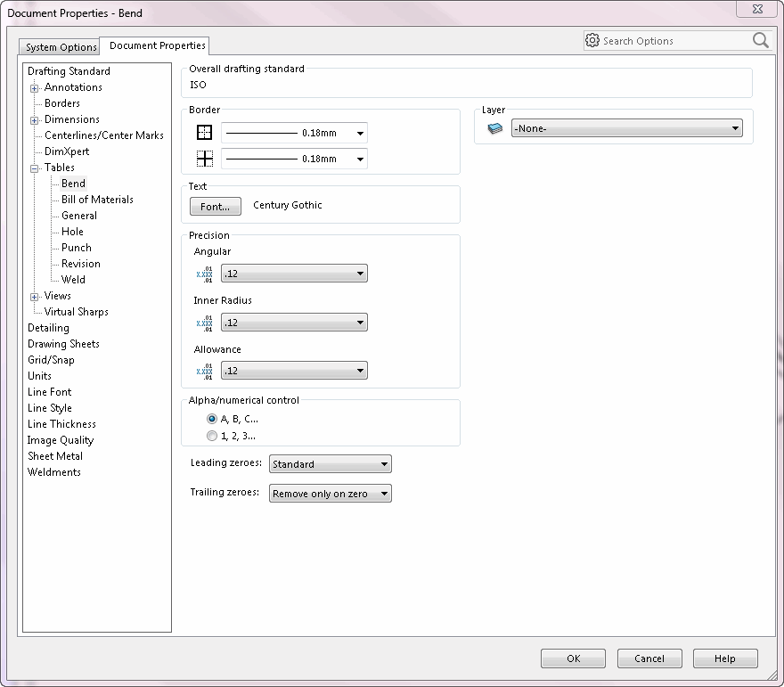

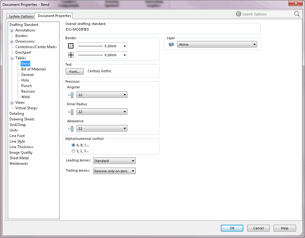

Document Properties > Tables > Bend
Valid for drawings only:
NOTE: Setting any of the following bend table values means that new bend tables added to the drawing use these default values. However, a bend table that uses a template table for insertion might not use these default values because the template table contains certain properties that take precedence over these default values.
Setting
Get/Set Methods
Return Value or <Value>
Comments
Border - Box Border
IModelDocExtension::GetUserPreferenceInteger(swUserPreferenceIntegerValue_e.swDetailingBendTableBorderLineWeight, swUserPreferenceOption_e.swDetailingNoOptionSpecified)
IModelDocExtension::SetUserPreferenceInteger(swUserPreferenceIntegerValue_e.swDetailingBendTableBorderLineWeight, swUserPreferenceOption_e.swDetailingNoOptionSpecified, swLineWeights_e.<Value>)
See swLineWeights_e for valid options
Border - Grid Border
ModelDocExtension::GetUserPreferenceInteger(swUserPreferenceIntegerValue_e.swDetailingBendTableGridLineWeight, swUserPreferenceOption_e.swDetailingNoOptionSpecified)
IModelDocExtension::SetUserPreferenceInteger(swUserPreferenceIntegerValue_e.swDetailingBendTableGridLineWeight, swUserPreferenceOption_e.swDetailingNoOptionSpecified, swLineWeights_e.<Value>)
Text - Font...
IModelDocExtension::GetUserPreferenceTextFormat(swUserPreferenceTextFormat_e.swDetailingBendTextFormat, swUserPreferenceOption_e.swDetailingNoOptionSpecified)
IModelDocExtension::SetUserPreferenceTextFormat(swUserPreferenceTextFormat_e.swDetailingBendTextFormat, swUserPreferenceOption_e.swDetailingNoOptionSpecified, <Value>)
See ITextFormat for font options
To set font property values, implement ITextFormat, set the appropriate ITextFormat member values, and pass the ITextFormat object in the set method
Precision - Angular
IModelDocExtension::GetUserPreferenceInteger(swUserPreferenceIntegerValue_e.swBendAngularPrecision, swUserPreferenceOption_e.swDetailingNoOptionSpecified)
IModelDocExtension::SetUserPreferenceInteger(swUserPreferenceIntegerValue_e.swBendAngularPrecision, swUserPreferenceOption_e.swDetailingNoOptionSpecified, <Value>)
Integer value
Specifies the number of digits of precision to display in the bend table for bend angles; specify a value from 0 through 8
Precision - Inner Radius
IModelDocExtension::GetUserPreferenceInteger(swUserPreferenceIntegerValue_e.swBendInnerRadiusPrecision, swUserPreferenceOption_e.swDetailingNoOptionSpecified)
IModelDocExtension::SetUserPreferenceInteger(swUserPreferenceIntegerValue_e.swBendInnerRadiusPrecision, swUserPreferenceOption_e.swDetailingNoOptionSpecified, <Value>)
Integer value
Specifies the number of digits of precision to display in the bend table for the inner radii of bends; specify a value from 0 through 8
Precision - Allowance
IModelDocExtension::GetUserPreferenceInteger(swUserPreferenceIntegerValue_e.swBendAllowancePrecision, swUserPreferenceOption_e.swDetailingNoOptionSpecified)
IModelDocExtension::SetUserPreferenceInteger(swUserPreferenceIntegerValue_e.swBendAllowancePrecision, swUserPreferenceOption_e.swDetailingNoOptionSpecified, <Value>)
Integer value
Specifies the number of digits of precision to display in the bend table for the bend allowance of bends; specify a value from 0 through 8
Alpha/numerical control
IModelDocExtension::GetUserPreferenceInteger(swUserPreferenceIntegerValue_e.swBendTableTagStyle, swUserPreferenceOption_e.swDetailingNoOptionSpecified)
IModelDocExtension::SetUserPreferenceInteger(swUserPreferenceIntegerValue_e.swBendTableTagStyle, swUserPreferenceOption_e.swDetailingNoOptionSpecified, swBendTableTagStyle_e.<Value>)
See swBendTableTagStyle_e for valid options
Specifies whether the bend tags are alphanumeric or numeric
Leading zeroes
IModelDocExtension::GetUserPreferenceInteger(swUserPreferenceIntegerValue_e.swBendLeadingZero, swUserPreferenceOption_e.swDetailingBendTable)
IModelDocExtension::SetUserPreferenceInteger(swUserPreferenceIntegerValue_e.swBendLeadingZero, swUserPreferenceOption_e.swDetailingBendTable, swDetailingLeadingZero_e.<Value>)
See swDetailingLeadingZero_e for valid options
Trailing zeroes
IModelDocExtension::GetUserPreferenceInteger(swUserPreferenceIntegerValue_e.swDetailingDimTrailingZero, swUserPreferenceOption_e.swDetailingBendTable)
IModelDocExtension::SetUserPreferenceInteger(swUserPreferenceIntegerValue_e.swDetailingDimTrailingZero, swUserPreferenceOption_e.swDetailingBendTable, swDetailingDimTrailingZero_e.<Value>)
Valid options in swDetailingDimTrailingZero_e:
  • swDimShowTrailingZeroes
  • swDimRemoveTrailingZeroes
  • swDimRemoveOnlyOnZero
  • swDimSameAsSource
Layer
IModelDocExtension::GetUserPreferenceString(swUserPreferenceStringValue_e.swDetailingLayer, swUserPreferenceOption_e.swDetailingBendTable)
IModelDocExtension::SetUserPreferenceString(swUserPreferenceStringValue_e.swDetailingLayer, swUserPreferenceOption_e.swDetailingBendTable, <Value>)
Valid options:
  • "Border"
  • "Dimensions"
  • "Notes"
  • "BOM"
  • "FORMAT"
  • "None"
This setting is available only on drawings; depending on drawing, some options may not apply
