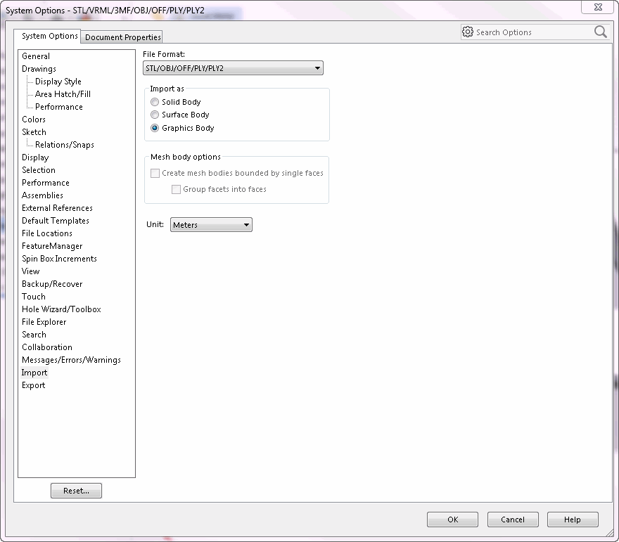

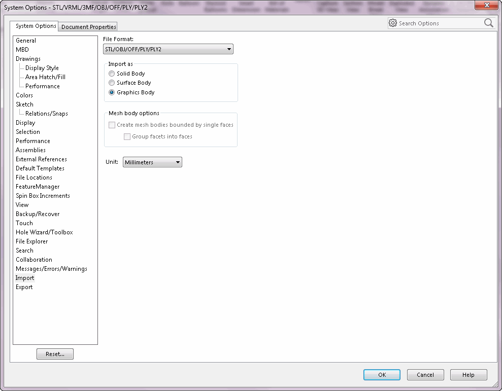

System Options > Import > STL/OBJ/OFF/PLY/PLY2
To display the dialog:
Click Tools > Options > System Options > Import > STL/OBJ/OFF/PLY/PLY2 in File Format.
- or -
  1. Click File > Open.
  2. In Files of type, select Mesh Files.
  3. Click Options.
Setting
Get/Set Methods
Return Value
or
<Value>
or
<OnFlag>
Comment
Import as - Graphics body
ISldWorks::GetUserPreferenceIntegerValue(swUserPreferenceIntegerValue_e.swImportStlVrmlModelType) ISldWorks::SetUserPreferenceIntegerValue(swUserPreferenceIntegerValue_e.swImportStlVrmlModelType, swImportStlVrmlModelType_e.swImportStlVrmlModelType_Graphics)
Import as - Solid body
ISldWorks::GetUserPreferenceIntegerValue(swUserPreferenceIntegerValue_e.swImportStlVrmlModelType) ISldWorks::SetUserPreferenceIntegerValue(swUserPreferenceIntegerValue_e.swImportStlVrmlModelType, swImportStlVrmlModelType_e.swImportStlVrmlModelType_Solid)
Import as - Surface body
ISldWorks::GetUserPreferenceIntegerValue(swUserPreferenceIntegerValue_e.swImportStlVrmlModelType) ISldWorks::SetUserPreferenceIntegerValue(swUserPreferenceIntegerValue_e.swImportStlVrmlModelType, swImportStlVrmlModelType_e.swImportStlVrmlModelType_Surface)
Mesh body options - Create mesh bodies bounded by single faces
ISldWorks::GetUserPreferenceToggle(swUserPreferenceToggle_e.swVrmlStlImportAsPSMesh)
ISldWorks::SetUserPreferenceToggle(swUserPreferenceToggle_e.swVrmlStlImportAsPSMesh, <OnFlag>)
Boolean value
Valid only when importing as Solid body or Surface body, specifies whether to create mesh bodies bounded by single faces
Mesh body options - Group facets into faces
ISldWorks::GetUserPreferenceToggle(swUserPreferenceToggle_e.swIVrmlStlImportSegmented)
ISldWorks::SetUserPreferenceToggle(swUserPreferenceToggle_e.swIVrmlStlImportSegmented, <OnFlag>)
Boolean value
Valid only if Create mesh bodies bounded by single faces is selected, specified whether to group facets into faces
Unit
ISldWorks::GetUserPreferenceIntegerValue(swUserPreferenceIntegerValue_e.swImportStlVrmlUnits) ISldWorks::SetUserPreferenceIntegerValue(swUserPreferenceIntegerValue_e.swImportStlVrmlUnits, swLengthUnit_e.<Value>)
Valid options from swLengthUnit_e:
  • 0 = swMM (millimeters)
  • 1 = swCM (centimeters)
  • 2 = swMETER
  • 3 = swINCHES
  • 4 = swFEET
