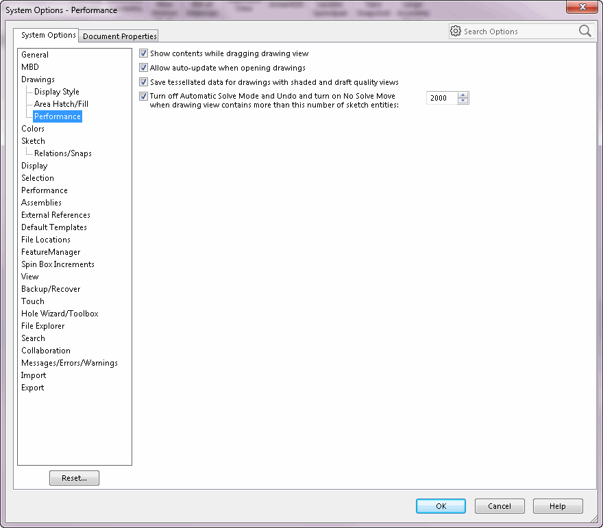

Show contents while dragging drawing view
ISldWorks::GetUserPreferenceToggle(swUserPreferenceToggle_e.swDrawingViewShowContentsWhileDragging)
ISldWorks::SetUserPreferenceToggle(swUserPreferenceToggle_e.swDrawingViewShowContentsWhileDragging, <OnFlag>)
Boolean value
Specifies whether model or view boundary is displayed when view is dragged
Allow auto-update when opening drawings
ISldWorks::GetUserPreferenceToggle(swUserPreferenceToggle_e.swAutomaticDrawingViewUpdateDefault
ISldWorks::SetUserPreferenceToggle(swUserPreferenceToggle_e.swAutomaticDrawingViewUpdateDefault, <OnFlag>)
Boolean value
Specifies whether drawing views are updated when a drawing is opened
Save tessellated data for drawings with shaded and draft quality views
ISldWorks::GetUserPreferenceToggle(swUserPreferenceToggle_e.swDrawingSaveShadedData)
ISldWorks::SetUserPreferenceToggle(swUserPreferenceToggle_e.swDrawingSaveShadedData, <OnFlag>)
Boolean value
Specifies whether to save tessellated data in drawing documents with shaded and draft quality views
Turn Off Automatic Solve Mode and Undo and turn on No Solve Mode when drawing view contains more than...
ISldWorks::GetUserPreferenceToggle(swUserPreferenceToggle_e.swDrawingTurnOffAutomaticSolveModeAndUndo)
ISldWorks::SetUserPreferenceToggle(swUserPreferenceToggle_e.swDrawingTurnOffAutomaticSolveModeAndUndo, <OnFlag>)
Boolean value
True to turn off Automatic Solve Mode and Undo and turn on No Solve Mode when drawing view contains more than the specified number of sketch entities
False to turn on Automatic Solve Mode and Undo and turn off No Solve Mode when drawing view contains more than the specified number of sketch entities
this number of sketch entities
ISldWorks::GetUserPreferenceIntegerValue(swUserPreferenceIntegerValue_e.swDrawing_Auto_Solve_Threshold) ISldWorks::SetUserPreferenceIntegerValue(swUserPreferenceIntegerValue_e.swDrawing_Auto_Solve_Threshold, <Value>)
Integer value
The specified number of sketch entities mentioned in the previous comment
