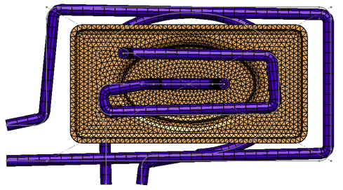

網格化冷卻水路 (SOLIDWORKS Plastics 2018)

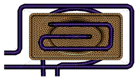

增強冷卻水路的網格 (SOLIDWORKS Plastics 2019)
