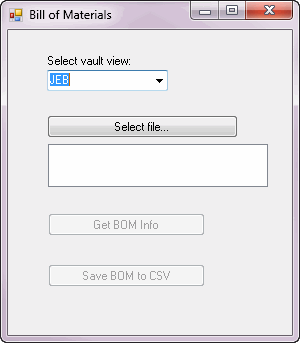

// 8. Click Debug > Start Debugging or press F5.
// Postconditions:
// 1. Opens the Bill of Materials dialog box.
// a. Select a vault_name view.
// b. Click Select file.
// c. In the Select File dialog:
// 1. Click the assembly specified in
Preconditions step 6.
// 2. Click Open.
// d. Click Get BOM Info.
// Displays message boxes containing:
// * Information about all named BOMs of the
assembly.
// * Version information for the named BOMs.
// * Information about all BOM layouts in
the vault.
// * Row and column information about a BOM
view in the BOM layout
// for the selected assembly in
its @ configuration.
// e. Click OK in each message box.
// f. Click Save BOM
to CSV.
// Saves the BOM to c:\temp\SavedBOM.csv.
// 2. Close the Bill of Materials dialog box.
// 3. Verify that c:\temp\SavedBOM.csv
is created.

this.SelectFiles.Text = "Select file...";
this.SelectFiles.UseVisualStyleBackColor = true;
this.SelectFiles.Click += new System.EventHandler(this.SelectFiles_Click);
// File1List
this.File1List.FormattingEnabled = true;
this.File1List.HorizontalScrollbar = true;
this.File1List.Location = new System.Drawing.Point(40, 114);
this.File1List.Name = "File1List";
this.File1List.SelectionMode = System.Windows.Forms.SelectionMode.MultiExtended;
this.File1List.Size = new System.Drawing.Size(220, 43);
this.File1List.TabIndex = 4;
// GetBOM
this.GetBOM.Location = new System.Drawing.Point(40, 183);
this.GetBOM.Name = "GetBOM";
this.GetBOM.Size = new System.Drawing.Size(157, 23);
this.GetBOM.TabIndex = 6;
this.GetBOM.Text = "Get BOM";
this.GetBOM.UseVisualStyleBackColor = true;
this.GetBOM.Enabled = false;
this.GetBOM.Click += new System.EventHandler(this.GetBOM_Click);
// OpenFileDialog1
this.OpenFileDialog1.FileName = "OpenFileDialog1";
this.OpenFileDialog1.Title = "Select File";
// SaveBOM
this.SaveBOM.Location = new System.Drawing.Point(40, 252);
this.SaveBOM.Name = "SaveBOM";
this.SaveBOM.Size = new System.Drawing.Size(157, 23);
this.SaveBOM.TabIndex = 7;
this.SaveBOM.Text = "Save BOM to CSV";
this.SaveBOM.UseVisualStyleBackColor = true;
this.SaveBOM.Enabled = false;
this.SaveBOM.Click += new System.EventHandler(this.SaveBOM_Click);
// Form1
this.AutoScaleDimensions = new System.Drawing.SizeF(6F, 13F);
this.AutoScaleMode = System.Windows.Forms.AutoScaleMode.Font;
this.ClientSize = new System.Drawing.Size(284, 363);
this.Controls.Add(this.SaveBOM);
this.Controls.Add(this.GetBOM);
this.Controls.Add(this.File1List);
this.Controls.Add(this.SelectFiles);
this.Controls.Add(this.VaultsComboBox);
this.Controls.Add(this.VaultsLabel);
this.Name = "Form1";
this.Text = "Bill of Materials";
this.Load += new System.EventHandler(this.Form1_Load);
this.ResumeLayout(false);
this.PerformLayout();
internal System.Windows.Forms.Label VaultsLabel;
internal System.Windows.Forms.ComboBox VaultsComboBox;
internal System.Windows.Forms.Button SelectFiles;
internal System.Windows.Forms.ListBox File1List;
internal System.Windows.Forms.Button GetBOM;
internal System.Windows.Forms.OpenFileDialog OpenFileDialog1;
#endregion
private System.Windows.Forms.Button SaveBOM;
