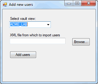

' Preconditions:
' 1. Create an XML file for this example.
' a. Open a text editor like Notepad and copy and paste this code
' into the editor.
' b. Save the file as User.xml and remember where you save the file.
' 2. Start Microsoft Visual Studio 2010.
' a. Click File > New > Project > Visual Basic > Windows Forms Application.
' b. Type AddUsers in Name.
' c. Click Browse and navigate to the folder where to create
' the project.
' d. Click OK.
' e. Click Show All Files in the Solution Explorer toolbar and expand
' Form1.vb in the Solution Explorer.
' f. Create a form similar to the form shown above and change:
' 1. Top label to VaultsLabel.
' 2. Combo box to VaultsComboBox.
' 3. Second label to XmlLabel.
' 4. Text box to XmlTextBox.
' 5. Browse button to BrowseButton.
' 6. Add users button to AddUsersButton.
' g. Replace the code in Form1.vb with this code.
' h. Replace the code in Form1.Designer.vb with this code.
' i. Right-click the AddUsers project name in the Solution Explorer.
' 1. Click Add > Class > Class.
' 2. Type EdmVaultSingleton.vb in Name.
' 3. Click Add.
' 4. Replace the code in EdmVaultSingleton.vb with this code.
' j. Right-click the AddUsers project name in the Solution Explorer.
' 2. Type User.vb in Name.
' 3. Click Add.
' 4. Replace the code in User.vb with this code.
' 3. Add EPDM.Interop.epdm.dll as a reference (right-click the project
' name in the Solution Explorer, click Add Reference, click
' Assemblies > Framework in the left-side panel, browse to the top folder of
' your SOLIDWORKS PDM Professional installation, locate and click
' EPDM.Interop.epdm.dll, click Open, click Add, and click Close).
' 4. Right-click EPDM.Interop.epdm in References, click Properties, and set
' Embed Interop Types to False to handle methods that pass arrays of
' structures.
' 5. Click Debug > Start Debugging or press F5.
' Postconditions:
' 1. Displays a dialog.
' 2. Select a vault.
' 3. Click Browse, locate and click User.xml, and click Open.
' 4. Click Add users.
' A message box is displayed showing the names and IDs of the new users added
' to the vault.
' 5. Click OK to close the message box.
' 6. Close the dialog.
' 7. Start and log into the SOLIDWORKS PDM Professional Administration
' tool as Admin.
' 8. Expand the vault where the new users were added.
' 9. Expand Users to see the names of the new users.
' 10. Double-click jdoe.
' a. Examine the properties.
' b. Click Administrative Permissions and examine the permissions.
' c. Click OK.
' 11. Double-click jsmith and repeat steps 10a - 10c.

Me.VaultsLabel.Name = "VaultsLabel"
Me.VaultsLabel.Size = New System.Drawing.Size(91, 13)
Me.VaultsLabel.TabIndex = 13
Me.VaultsLabel.Text = "Select vault view:"
'AddUsers
Me.AutoScaleDimensions = New System.Drawing.SizeF(6.0!, 13.0!)
Me.AutoScaleMode = System.Windows.Forms.AutoScaleMode.Font
Me.ClientSize = New System.Drawing.Size(304, 237)
Me.Controls.Add(Me.VaultsComboBox)
Me.Controls.Add(Me.VaultsLabel)
Me.Controls.Add(Me.AddUsersButton)
Me.Controls.Add(Me.XmlLabel)
Me.Controls.Add(Me.XmlTextBox)
Me.Controls.Add(Me.BrowseButton)
Me.Margin = New System.Windows.Forms.Padding(2)
Me.Name = "AddUsers"
Me.Text = "Add new users"
Me.ResumeLayout(False)
Me.PerformLayout()
