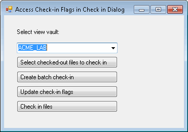

'  4. Ensure that a file in the targeted vault is checked out by a user
'     other than Admin.
'  5. Log into the targeted vault as Admin.
'  6. Click Debug > Start Debugging or press F5.
' Postconditions:
' 1. Displays the Access Check-in Flags in Check in Dialog dialog box.
' 2. Select the vault view where you are logged in as Admin.
' 3. Click Select checked-out files to check in.
'    a. Displays the Select files dialog box.
'    b. Select the file verified as checked out by a user other than
'       Admin.
'    c. Click Open.
' 4. Click Create batch check-in
'    a. Displays message boxes with callback information.
'    b. Click OK to close each message box.
'    c. Displays a message box verifying that the batch check-in
'       was created.
'    d. Click OK to close the message box.
' 5. Click Update check-in flags.
'    a. Displays a message box verifying that check-in flags were updated.
'    b. Click OK to close the message box.
' 6. Click Check in files.
'    a. Displays the Check in dialog box.
'    b. Select the Check in check box.
'    c. Click the Check in button.
'    d. Displays message boxes with callback information.
'    e. Click OK to close each message box.
'    f. Displays an error message informing you that the file is not
'       checked out by Admin.
'    g. Click OK to close the error message.
' 7. Open a File Explorer view of the selected vault and verify that the
'    file that you selected to check in is still checked out.
' 8. Close the Access Check-in Flags in Check in Dialog dialog box.

        Me.VaultsLabel.Location = New System.Drawing.Point(22, 26)
        Me.VaultsLabel.Name = "VaultsLabel"
        Me.VaultsLabel.Size = New System.Drawing.Size(91, 13)
        Me.VaultsLabel.TabIndex = 0
        Me.VaultsLabel.Text = "Select view vault:"
        'VaultsComboBox
        Me.VaultsComboBox.FormattingEnabled = True
        Me.VaultsComboBox.Location = New System.Drawing.Point(25, 54)
        Me.VaultsComboBox.Name = "VaultsComboBox"
        Me.VaultsComboBox.Size = New System.Drawing.Size(199, 21)
        Me.VaultsComboBox.TabIndex = 1
        'BrowseButton
        Me.BrowseButton.Location = New System.Drawing.Point(25, 81)
        Me.BrowseButton.Name = "BrowseButton"
        Me.BrowseButton.Size = New System.Drawing.Size(199, 23)
        Me.BrowseButton.TabIndex = 2
        Me.BrowseButton.Text = "Select checked-out files to check in"
        Me.BrowseButton.TextAlign = System.Drawing.ContentAlignment.MiddleLeft
        Me.BrowseButton.UseVisualStyleBackColor = True
        'CreateBatchCheckinButton
        Me.CreateBatchCheckinButton.Location = New System.Drawing.Point(25, 110)
        Me.CreateBatchCheckinButton.Name = "CreateBatchCheckinButton"
        Me.CreateBatchCheckinButton.Size = New System.Drawing.Size(199, 23)
        Me.CreateBatchCheckinButton.TabIndex = 3
        Me.CreateBatchCheckinButton.Text = "Create batch check-in"
        Me.CreateBatchCheckinButton.TextAlign = System.Drawing.ContentAlignment.MiddleLeft
        Me.CreateBatchCheckinButton.UseVisualStyleBackColor = True
        'UpdateBatchCheckInButton
        Me.UpdateBatchCheckInButton.Location = New System.Drawing.Point(25, 139)
        Me.UpdateBatchCheckInButton.Name = "UpdateBatchCheckInButton"
        Me.UpdateBatchCheckInButton.Size = New System.Drawing.Size(199, 23)
        Me.UpdateBatchCheckInButton.TabIndex = 4
        Me.UpdateBatchCheckInButton.Text = "Update check-in flags"
        Me.UpdateBatchCheckInButton.TextAlign = System.Drawing.ContentAlignment.MiddleLeft
        Me.UpdateBatchCheckInButton.UseVisualStyleBackColor = True
        'CheckInButton
        Me.CheckInButton.Location = New System.Drawing.Point(25, 168)
        Me.CheckInButton.Name = "CheckInButton"
        Me.CheckInButton.Size = New System.Drawing.Size(199, 23)
        Me.CheckInButton.TabIndex = 5
        Me.CheckInButton.Text = "Check in files"
        Me.CheckInButton.TextAlign = System.Drawing.ContentAlignment.MiddleLeft
        Me.CheckInButton.UseVisualStyleBackColor = True
        'Form1
        Me.AutoScaleDimensions = New System.Drawing.SizeF(6.0!, 13.0!)
        Me.AutoScaleMode = System.Windows.Forms.AutoScaleMode.Font
        Me.ClientSize = New System.Drawing.Size(355, 222)
        Me.Controls.Add(Me.CheckInButton)
        Me.Controls.Add(Me.UpdateBatchCheckInButton)
        Me.Controls.Add(Me.CreateBatchCheckinButton)
        Me.Controls.Add(Me.BrowseButton)
        Me.Controls.Add(Me.VaultsComboBox)
        Me.Controls.Add(Me.VaultsLabel)
        Me.Name = "Form1"
        Me.Text = "Access Check-in Flags in Check in Dialog"
        Me.ResumeLayout(False)
        Me.PerformLayout()
    End Sub
    Friend WithEvents VaultsLabel As System.Windows.Forms.Label
    Friend WithEvents VaultsComboBox As System.Windows.Forms.ComboBox
    Friend WithEvents BrowseButton As System.Windows.Forms.Button
    Friend WithEvents CreateBatchCheckinButton As System.Windows.Forms.Button
    Friend WithEvents UpdateBatchCheckInButton As System.Windows.Forms.Button
    Friend WithEvents CheckInButton As System.Windows.Forms.Button
End Class
