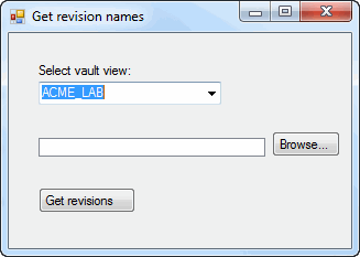

' Postconditions:
' 1. Displays the Get revision names dialog box.
' 2. Select a vault view.
' 3. Click Browse.
' 4. Displays the Select a file dialog box.
'    a. Click the file identified in Preconditions step 4 in the
'       selected vault.
'    b. Click Open to display the selected file's path and file
'       name in the Get revision names dialog box.
' 5. Click Get revisions.
' 6. Displays a message box listing the names of the revisions
'    for the selected file. Click OK to close the message box.
' 7. Displays a message box showing the revision to which the file
'    was rolled back and the current version. Click OK to close the
'    message box.
' 8. Close the Get revision names dialog box.
' 9. Click the file in the vault in File Explorer for which revisions
'    were rolled back.
'    a. Click Display > History.
'    b. Scroll down and examine the Event, Version, and Comment columns.

        Me.Text = "Get revision names"
