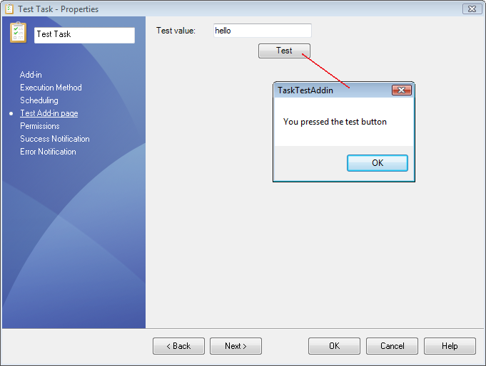

The following is a resource template of the custom set-up page that is displayed
in the Task property dialog box by TaskAddIn::OnTaskSetup.
It is a user control in Visual Studio with an edit box named TextBox1 and a
button named TestButton.
The code behind the custom set-up page is as follows.

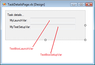

The following
is the resource

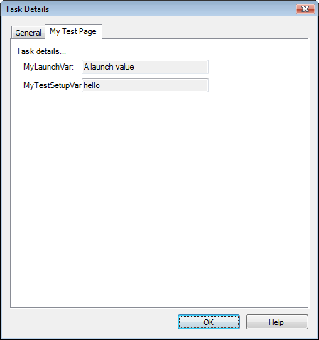

template of the extra details page added by TaskAddIn::OnTaskDetails.
It is a user control in Visual Studio that displays two task variables:
The code behind the extra details
page:

The following is the set-up page
when the add-in is used in a task.
The following is the task details
page when opened from the task list.

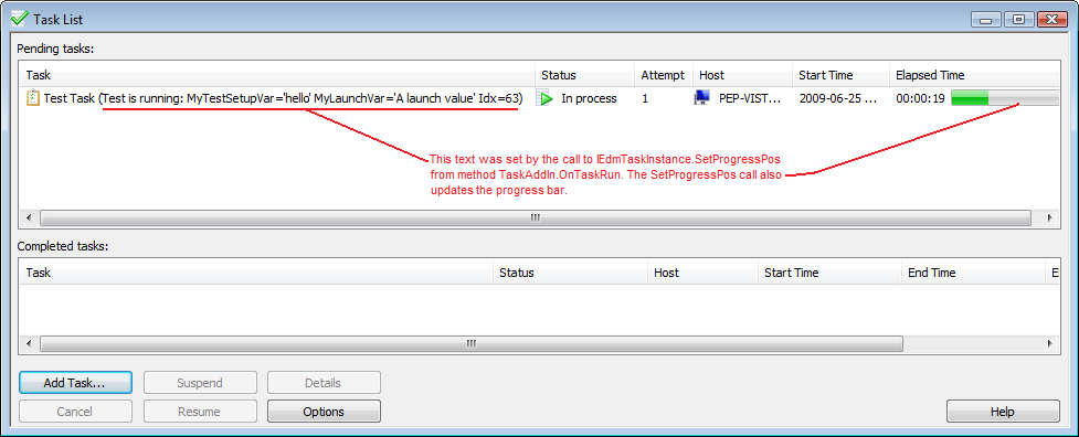

The following is the task list during task execution.
