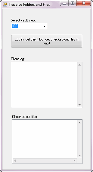

' Postconditions:
' 1. Displays a Traverse Folders and Files dialog.
' 2. Select a vault.
' 3. Click Log in, get client log, get checked-out files in vault.
' 4. Displays a message box with the vault type.
' 5. Click OK.
' 6. Populates Client log and Checked-out files.
' 7. Close the dialog.

    <System.Diagnostics.DebuggerStepThrough()> _
    Private Sub InitializeComponent()
        Me.Label1 = New System.Windows.Forms.Label()
        Me.VaultsComboBox = New System.Windows.Forms.ComboBox()
        Me.TraverseFoldersButton = New System.Windows.Forms.Button()
        Me.Label2 = New System.Windows.Forms.Label()
        Me.Label3 = New System.Windows.Forms.Label()
        Me.ListBox2 = New System.Windows.Forms.ListBox()
        Me.TextBox1 = New System.Windows.Forms.TextBox()
        Me.SuspendLayout()
        'Label1
        Me.Label1.AutoSize = True
        Me.Label1.Location = New System.Drawing.Point(22, 34)
        Me.Label1.Name = "Label1"
        Me.Label1.Size = New System.Drawing.Size(91, 13)
        Me.Label1.TabIndex = 0
        Me.Label1.Text = "Select vault view:"
        'VaultsComboBox
        Me.VaultsComboBox.FormattingEnabled = True
        Me.VaultsComboBox.Location = New System.Drawing.Point(25, 50)
        Me.VaultsComboBox.Name = "VaultsComboBox"
        Me.VaultsComboBox.Size = New System.Drawing.Size(121, 21)
        Me.VaultsComboBox.TabIndex = 1
        'TraverseFoldersButton
        Me.TraverseFoldersButton.Location = New System.Drawing.Point(25, 89)
        Me.TraverseFoldersButton.Name = "TraverseFoldersButton"
        Me.TraverseFoldersButton.Size = New System.Drawing.Size(212, 34)
        Me.TraverseFoldersButton.TabIndex = 2
        Me.TraverseFoldersButton.Text = "Log in, get client log, get checked-out files in vault"
        Me.TraverseFoldersButton.UseVisualStyleBackColor = True
        'Label2
        Me.Label2.AutoSize = True
        Me.Label2.Location = New System.Drawing.Point(22, 144)
        Me.Label2.Name = "Label2"
        Me.Label2.Size = New System.Drawing.Size(53, 13)
        Me.Label2.TabIndex = 4
        Me.Label2.Text = "Client log:"
        'Label3
        Me.Label3.AutoSize = True
        Me.Label3.Location = New System.Drawing.Point(24, 310)
        Me.Label3.Name = "Label3"
        Me.Label3.Size = New System.Drawing.Size(89, 13)
        Me.Label3.TabIndex = 5
        Me.Label3.Text = "Checked-out files:"
        'ListBox2
        Me.ListBox2.FormattingEnabled = True
        Me.ListBox2.HorizontalScrollbar = True
        Me.ListBox2.Location = New System.Drawing.Point(27, 326)
        Me.ListBox2.Name = "ListBox2"
        Me.ListBox2.ScrollAlwaysVisible = True
        Me.ListBox2.SelectionMode = System.Windows.Forms.SelectionMode.None
        Me.ListBox2.Size = New System.Drawing.Size(210, 160)
        Me.ListBox2.TabIndex = 6
        'TextBox1
        Me.TextBox1.Location = New System.Drawing.Point(25, 160)
        Me.TextBox1.Multiline = True
        Me.TextBox1.Name = "TextBox1"
        Me.TextBox1.ScrollBars = System.Windows.Forms.ScrollBars.Both
        Me.TextBox1.Size = New System.Drawing.Size(212, 147)
        Me.TextBox1.TabIndex = 7
        'TraverseFilesFolders
        Me.AutoScaleDimensions = New System.Drawing.SizeF(6.0!, 13.0!)
        Me.AutoScaleMode = System.Windows.Forms.AutoScaleMode.Font
        Me.ClientSize = New System.Drawing.Size(258, 509)
        Me.Controls.Add(Me.TextBox1)
        Me.Controls.Add(Me.ListBox2)
        Me.Controls.Add(Me.Label3)
        Me.Controls.Add(Me.Label2)
        Me.Controls.Add(Me.TraverseFoldersButton)
        Me.Controls.Add(Me.VaultsComboBox)
        Me.Controls.Add(Me.Label1)
        Me.Name = "TraverseFilesFolders"
        Me.Text = "Traverse Folders and Files"
        Me.ResumeLayout(False)
        Me.PerformLayout()
    End Sub
    Friend WithEvents Label1 As System.Windows.Forms.Label
    Friend WithEvents VaultsComboBox As System.Windows.Forms.ComboBox
    Friend WithEvents TraverseFoldersButton As System.Windows.Forms.Button
    Friend WithEvents Label2 As Label
    Friend WithEvents Label3 As Label
    Friend WithEvents ListBox2 As ListBox
    Friend WithEvents TextBox1 As TextBox
End Class
