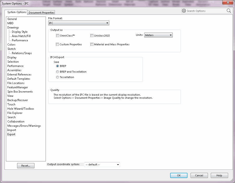

System Options > Export > IFC
This topic contains two tables. The information in the table:
- appearing immediately after the dialog corresponds to the settings on that dialog.
- titled Obsolete
Enumerators contains enumerators that previously appeared on
the dialog but are now obsolete.
To display the dialog:
Click Tools > Options > System Options > Export > IFC in File
Format.
- or -
- Click File > Save As.
- In Save as type, select IFC 2x3 or IFC 4.
- Click Options.
Obsolete Enumerators
Enumerator |
Comment |
swIFCOmniUniClassPreference |
Obsolete |
swExportIFCUniClass2 |
Obsolete |
swExportIFCType |
Obsolete |
