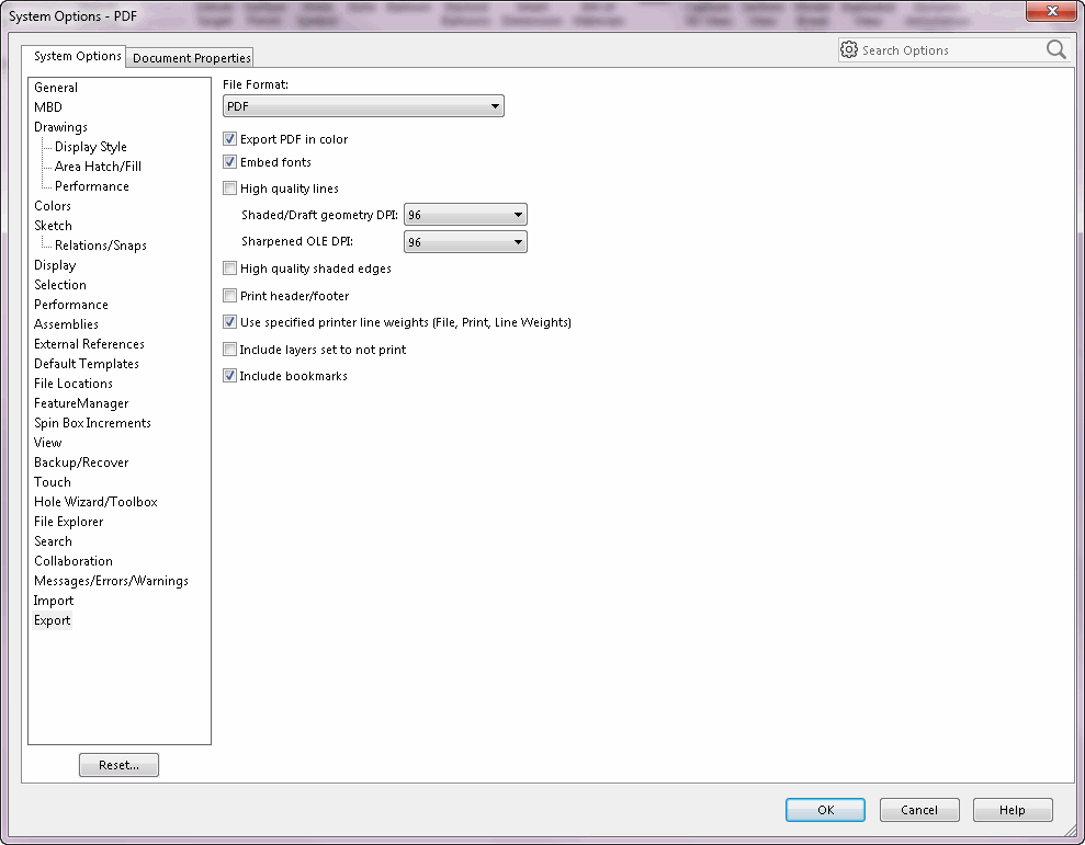

System Options > Export > PDF
To display the dialog:
Click Tools > Options > System Options > Export > PDF in File Format.
- or -
  1. Click File > Save As.
  2. In Save as type, select Adobe Portable Document Format.
  3. Click Options.
Setting
Get/Set Methods
Return Value
or
<OnFlag>
Comment
Export PDF in color
ISldWorks::GetUserPreferenceToggle(swUserPreferenceToggle_e.swPDFExportInColor)
ISldWorks::SetUserPreferenceToggle(swUserPreferenceToggle_e.swPDFExportInColor, <OnFlag>)
Boolean value
Specifies whether to save documents in color when saving to PDF
Embed fonts
ISldWorks::GetUserPreferenceToggle(swUserPreferenceToggle_e.swPDFExportEmbedFonts)
ISldWorks::SetUserPreferenceToggle(swUserPreferenceToggle_e.swPDFExportEmbedFonts, <OnFlag>)
Boolean value
Specifies whether to embed fonts when saving documents  to PDF
High quality lines
ISldWorks::GetUserPreferenceToggle(swUserPreferenceToggle_e.swPDFExportHighQuality)
ISldWorks::SetUserPreferenceToggle(swUserPreferenceToggle_e.swPDFExportHighQuality, <OnFlag>)
Boolean value
Specifies whether to save drawing documents in high quality when saving to PDF
Shaded/Draft geometry DPI
ISldWorks::GetUserPreferenceIntegerValue(swUserPreferenceIntegerValue_e.swPDFExportShadedDraftDPI)
ISldWorks::SetUserPreferenceIntegerValue(swUserPreferenceIntegerValue_e.swPDFExportShadedDraftDPI, <Value>)
Integer value
For drawings only; controls dots per inch (DPI) setting for shaded and draft geometry; increased value improves quality while increasing the file size and the time to save the file
Sharpened OLE DPI
ISldWorks::GetUserPreferenceIntegerValue(swUserPreferenceIntegerValue_e.swPDFExportOleDPI)
ISldWorks::SetUserPreferenceIntegerValue(swUserPreferenceIntegerValue_e.swPDFExportOleDPI, <Value>)
Integer value
For drawings only; controls DPI setting for Object Linking and Embedding (OLE) objects; increased value improves quality while increasing the file size and the time to save the file
High quality shaded edges
ISldWorks::GetUserPreferenceToggle(swUserPreferenceToggle_e.swPDFExportShadedEdgesHighQuality)
ISldWorks::SetUserPreferenceToggle(swUserPreferenceToggle_e.swPDFExportShadedEdgesHighQuality, <OnFlag>)
Boolean value
Print header/footer
ISldWorks::GetUserPreferenceToggle(swUserPreferenceToggle_e.swPDFExportPrintHeaderFooter)
ISldWorks::SetUserPreferenceToggle(swUserPreferenceToggle_e.swPDFExportPrintHeaderFooter, <OnFlag>)
Boolean value
Specifies whether to use the header and footer specified in File > Print > Header Footer when saving documents to PDF
Use specified printer line weights (File > Print > Line Weights)
ISldWorks::GetUserPreferenceToggle(swUserPreferenceToggle_e.swPDFExportUseCurrentPrintLineWeights)
ISldWorks::SetUserPreferenceToggle(swUserPreferenceToggle_e.swPDFExportUseCurrentPrintLineWeights, <OnFlag>)
Boolean value
Specifies whether to use the default printer line weights when saving documents to PDF
Include layers set to not print
ISldWorks::GetUserPreferenceToggle(swUserPreferenceToggle_e.swPDFExportIncludeLayersNotToPrint)
ISldWorks::SetUserPreferenceToggle(swUserPreferenceToggle_e.swPDFExportIncludeLayersNotToPrint, <OnFlag>)
Boolean value
Specifies whether to include layers set not to print
