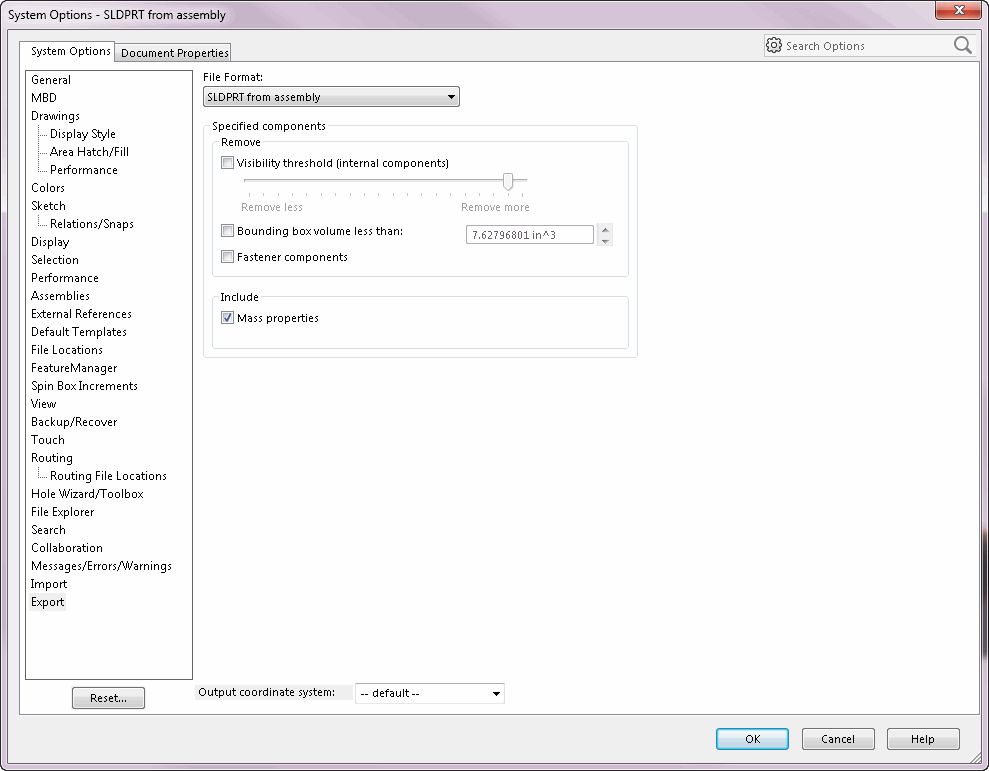

Setting |
Get/Set Methods |
Return Value
or
<Value>
or
<OnFlag> |
Comment |
Specified components - Remove - Visibility threshold (internal components) |
ISldWorks::GetUserPreferenceToggle(swUserPreferenceToggle_e.swASMSLDPRT_ExcludeComponentsByVisibility)
ISldWorks::SetUserPreferenceToggle(swUserPreferenceToggle_e.swASMSLDPRT_ExcludeComponentsByVisibility,
<OnFlag>)
Boolean value |
Specifies whether to remove from the export list those internal components whose
visibility is less than the threshold specified by swASMSLDPRT_ExcludeComponentsByVisibilityThreshold |
Specified components - Remove - Visibility threshold (internal components) -
(slider amount) |
ISldWorks::GetUserPreferenceDoubleValue(swUserPreferenceDoubleValue_e.swASMSLDPRT_ExcludeComponentsByVisibilityThreshold)
ISldWorks::SetUserPreferenceDoubleValue(swUserPreferenceDoubleValue_e.swASMSLDPRT_ExcludeComponentsByVisibilityThreshold,
<Value>) |
Double value in meters-cubed |
Valid only if swASMSLDPRT_ExcludeComponentsByVisibility is set to true |
Specified components - Remove - Bounding box volume less than: |
ISldWorks::GetUserPreferenceToggle(swUserPreferenceToggle_e.swExcludeComponentsByBBoxVolume)
ISldWorks::SetUserPreferenceToggle(swUserPreferenceToggle_e.swExcludeComponentsByBBoxVolume,
<OnFlag>) |
Boolean value |
Specifies whether to remove from the export list those components whose
bounding box volumes are less than the threshold specified by swASMSLDPRT_ExcludeComponentsByBBoxVolumeThreshold |
Specified components - Remove - Bounding box volume less than: (amount) |
ISldWorks::GetUserPreferenceDoubleValue(swUserPreferenceDoubleValue_e.swASMSLDPRT_ExcludeComponentsByBBoxVolumeThreshold)
ISldWorks::SetUserPreferenceDoubleValue(swUserPreferenceDoubleValue_e.swASMSLDPRT_ExcludeComponentsByBBoxVolumeThreshold,
<Value>) |
Valid only if swExcludeComponentsByBBoxVolume is set to true |
Specified components - Remove - Fastener components |
ISldWorks::GetUserPreferenceToggle(swUserPreferenceToggle_e.swASMSLDPRT_ExcludeIfToolboxComponents)
ISldWorks::SetUserPreferenceToggle(swUserPreferenceToggle_e.swASMSLDPRT_ExcludeIfToolboxComponents,
<OnFlag>) |
Boolean value |
Specifies whether to remove from the export list fastener components |
Specified components - Include - Mass properties |
ISldWorks::GetUserPreferenceToggle(swUserPreferenceToggle_e.swASMSLDPRT_IncludeMassProperties)
ISldWorks::SetUserPreferenceToggle(swUserPreferenceToggle_e.swASMSLDPRT_IncludeMassProperties,
<OnFlag>) |
Boolean value |
Specifies whether to override the mass properties of the part with the mass
properties from the assembly |
