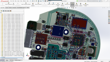

Copper Support Copper is supported – traces, pads, and polygons – from ECAD to MCAD. There are two options: Decal imagery for reference/visualization. Solid modeled copper for all layers. Parent topicPCB Connector/ECAD-MCAD Collaboration
