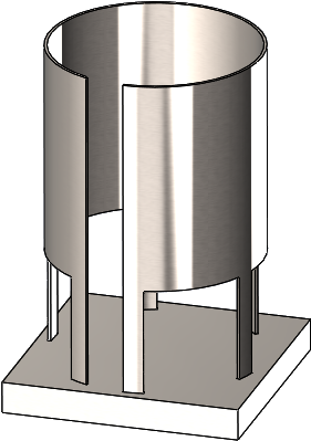

Nonlinear Edges
You can select nonlinear edges when creating a tab and slot feature.

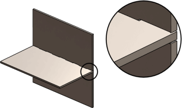

| No
Through Cut cleared |
No
Through Cut selected |
