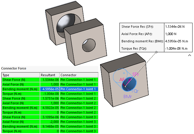

When viewing pin connector results, in the Result
Force PropertyManager, click a table cell under Connector Force to highlight the location of the
selected pin joint. A callout lists the pin forces at the selected joint. The directions
of the pin resultant forces with respect to the pin's local coordinate system are also
displayed: shear force resultant, axial force resultant, bending moment resultant, and
torque resultant.
![](utp1529970105608.image)
Click List X,Y,Z components to
list the X, Y, and Z components of the pin forces with respect to the global coordinate
system.
