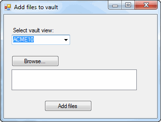

// Postconditions:
// 1. Displays the Add files to vault dialog box.
//    a. Select a vault view.
//    b. Click Browse
//       1. Locate and click three files outside the vault.
//       2. Click Open.
//    c. Click Add files.
//       1. Adds the selected files to the root folder of the vault.
//       2. Checks in the files.
//       3. Creates path \temp\files in the root folder.
//       4. Moves one of the files to subfolder \temp\files.
//       5. Copies one of the files to subfolder \temp.
//       6. Changes the state of one of the files in the root folder to
//          Waiting for Approval.
// 2. Click OK to close each message box.
// 3. Examine the vault.
// 4. Close the Add files to vault dialog box.

            //VaultsComboBox
            this.VaultsComboBox.FormattingEnabled = true;
            this.VaultsComboBox.Location = new System.Drawing.Point(16, 42);
            this.VaultsComboBox.Name = "VaultsComboBox";
            this.VaultsComboBox.Size = new System.Drawing.Size(121, 21);
            this.VaultsComboBox.TabIndex = 1;
            //BrowseButton
            this.BrowseButton.Location = new System.Drawing.Point(16, 85);
            this.BrowseButton.Name = "BrowseButton";
            this.BrowseButton.Size = new System.Drawing.Size(98, 23);
            this.BrowseButton.TabIndex = 3;
            this.BrowseButton.Text = "Browse...";
            this.BrowseButton.UseVisualStyleBackColor = true;
            this.BrowseButton.Click +=new System.EventHandler(BrowseButton_Click);
            //ListBox
            this.ListBox.FormattingEnabled = true;
            this.ListBox.HorizontalScrollbar = true;
            this.ListBox.Location = new System.Drawing.Point(16, 114);
            this.ListBox.Name = "ListBox";
            this.ListBox.SelectionMode = System.Windows.Forms.SelectionMode.MultiExtended;
            this.ListBox.Size = new System.Drawing.Size(259, 43);
            this.ListBox.TabIndex = 4;
            //AddFiles
            this.AddFiles.Location = new System.Drawing.Point(84, 178);
            this.AddFiles.Name = "AddFiles";
            this.AddFiles.Size = new System.Drawing.Size(98, 23);
            this.AddFiles.TabIndex = 5;
            this.AddFiles.Text = "Add files";
            this.AddFiles.UseVisualStyleBackColor = true;
            this.AddFiles.Click +=new System.EventHandler(AddFiles_Click);
            //OpenFileDialog
            this.OpenFileDialog.Multiselect = true;
            this.OpenFileDialog.Title = "Open";
            //Form1
            this.AutoScaleDimensions = new System.Drawing.SizeF(6f, 13f);
            this.AutoScaleMode = System.Windows.Forms.AutoScaleMode.Font;
            this.ClientSize = new System.Drawing.Size(317, 215);
            this.Controls.Add(this.AddFiles);
            this.Controls.Add(this.ListBox);
            this.Controls.Add(this.BrowseButton);
            this.Controls.Add(this.VaultsComboBox);
            this.Controls.Add(this.VaultsLabel);
            this.Name = "Form1";
            this.Text = "Add files to vault";
            this.Load += new System.EventHandler(this.Form1_Load);
            this.ResumeLayout(false);
            this.PerformLayout();
