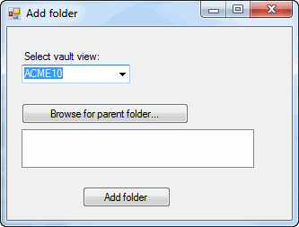

// Postconditions:
// 1. Displays the Add folder dialog box.
//    a. Select a vault view.
//    b. Click Browse for parent folder
//       1. Locate and click a folder in the vault.
//       2. Click OK.
//    c. Click Add folder.

            this.VaultsLabel = new System.Windows.Forms.Label();
            this.VaultsComboBox = new System.Windows.Forms.ComboBox();
            this.BrowseButton = new System.Windows.Forms.Button();
            this.ListBox = new System.Windows.Forms.ListBox();
            this.AddFolder = new System.Windows.Forms.Button();
            this.FolderBrowserDialog1 = new System.Windows.Forms.FolderBrowserDialog();
            this.SuspendLayout();
            //VaultsLabel
            this.VaultsLabel.AutoSize = true;
            this.VaultsLabel.Location = new System.Drawing.Point(13, 26);
            this.VaultsLabel.Name = "VaultsLabel";
            this.VaultsLabel.Size = new System.Drawing.Size(94, 13);
            this.VaultsLabel.TabIndex = 0;
            this.VaultsLabel.Text = " Select vault view:";
            //VaultsComboBox
            this.VaultsComboBox.FormattingEnabled = true;
            this.VaultsComboBox.Location = new System.Drawing.Point(16, 42);
            this.VaultsComboBox.Name = "VaultsComboBox";
            this.VaultsComboBox.Size = new System.Drawing.Size(121, 21);
            this.VaultsComboBox.TabIndex = 1;
            //BrowseButton
            this.BrowseButton.Location = new System.Drawing.Point(16, 85);
            this.BrowseButton.Name = "BrowseButton";
            this.BrowseButton.Size = new System.Drawing.Size(186, 23);
            this.BrowseButton.TabIndex = 3;
            this.BrowseButton.Text = "Browse for parent folder...";
            this.BrowseButton.UseVisualStyleBackColor = true;
            this.BrowseButton.Click +=new System.EventHandler(BrowseButton_Click);
            //ListBox
            this.ListBox.FormattingEnabled = true;
            this.ListBox.HorizontalScrollbar = true;
            this.ListBox.Location = new System.Drawing.Point(16, 114);
            this.ListBox.Name = "ListBox";
            this.ListBox.Size = new System.Drawing.Size(259, 43);
            this.ListBox.TabIndex = 4;
            //AddFolder
            this.AddFolder.Location = new System.Drawing.Point(84, 178);
            this.AddFolder.Name = "AddFolder";
            this.AddFolder.Size = new System.Drawing.Size(98, 23);
            this.AddFolder.TabIndex = 5;
            this.AddFolder.Text = "Add folder";
            this.AddFolder.UseVisualStyleBackColor = true;
            this.AddFolder.Click +=new System.EventHandler(AddFolder_Click);
